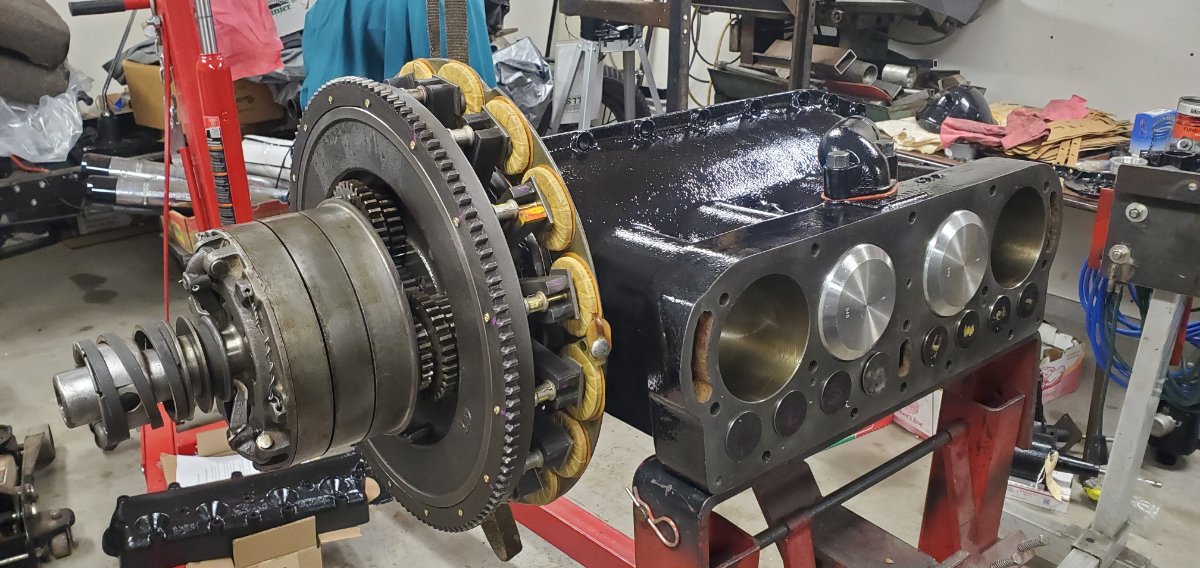

Re: knocking engine
Posted: Tue Mar 28, 2023 5:32 pm
by ElGranadaT
some images
Re: knocking engine
Posted: Tue Mar 28, 2023 5:37 pm
by Scott_Conger
Oh my... :?
Unfortunately, I would suspect more things wrong than right...you have your work cut out for you and you might as well be prepared to do the full monte rather than hunt and peck looking for "the problem" (there are lots of them).
Good luck.

Posted: Wed Mar 29, 2023 5:30 pm
by ElGranadaT
Thank you all again for the great advice.
I think I may have found the culprit - The attached image is of No. 1 piston - Its scored and the bottom of the cylinder is also scored -
the wrist pin slides very easily - with lots of play- No. 2,3,and 4 pistons are not that bad... and those pistons and cylinders have no scoring or discoloration.
Thanks to my local club, I was given a link to a local machinist who has the original Ford tooling and can handle a rework - I'll bring him the
engine and hope for the best.
Although I had planned on naming this car after my wife, I'm beginning to think I now need to change it to $ 'cha-ching' $
thanks all again - and keep em' flyin'
Marty

Re: knocking engine
Posted: Wed Mar 29, 2023 5:50 pm
by TXGOAT2
Could be much worse. Pistons are cheap, as things go these days. The blue goop and improper rod bearing fit and compromised rod cap bolt indicate a need for further investigation.
Re: knocking engine
Posted: Wed Mar 29, 2023 6:27 pm
by speedytinc
Check that internal oil line. (it looks like a piece of copper tubing in a picture). I wonder whats going on with that.
# 1 rod & piston are the first to fail under a lack of oil.

Re: knocking engine
Posted: Fri Mar 31, 2023 12:58 pm
by ElGranadaT
Part of the why or one bore too tight?
you nailed it - Took it to Dave Rich in Forestville yesterday (excellent T machinist!) - The scupper from the hogs head was clogged with a piece of material from the brakes- and no. 1,3 and 4 wrist pins were loose- No. 2 wrist pin was very tight- The theory has it that Aluminum piston expands the wrist pin hole and the wrist pins begin to knock - I've heard a few people now comment that they had wrist pin failure. Seems the original cast iron pistons were better than the Aluminum -
I live in the hills and a friend recommended a Texas T auxiliary oiler to the front of the engine -
I learn something new every day- too bad I'm starting to forget TWO things every day also...
Re: knocking engine
Posted: Fri Mar 31, 2023 2:24 pm
by Scott_Conger
Martin
your plugged oil line is one reason I always pull the right-front bolt from the lower inspection plate and start the engine on any T that is new to me or brought for service...with a catch pan below, and the engine running, if oil does not emanate forth with a healthy flow, the engine is turned off and hog's head inspection performed before the engine is ever started again.
It's a bit of wisdom you will rarely if ever, hear from anyone else, but your plight is a perfect example of why I believe that it is a good idea. Hopefully you will be able to refresh your engine with minimal effort, though from your pictures, there should be a ton of preventative inspection performed...sounds like you're on the right track.
Re: knocking engine
Posted: Fri Mar 31, 2023 2:46 pm
by BUSHMIKE
Martin
Scott,
that is a fantastic tip! Ill try it tomorrow as I noticed the oil line kinked in several places from the rod cotters hitting it.
Re: knocking engine
Posted: Fri Mar 31, 2023 2:54 pm
by speedytinc
Those kinks each form natural dams for the band fuzz & other muck to hang up on.
You can have a blocked line not obvious looking @ the funnel.
