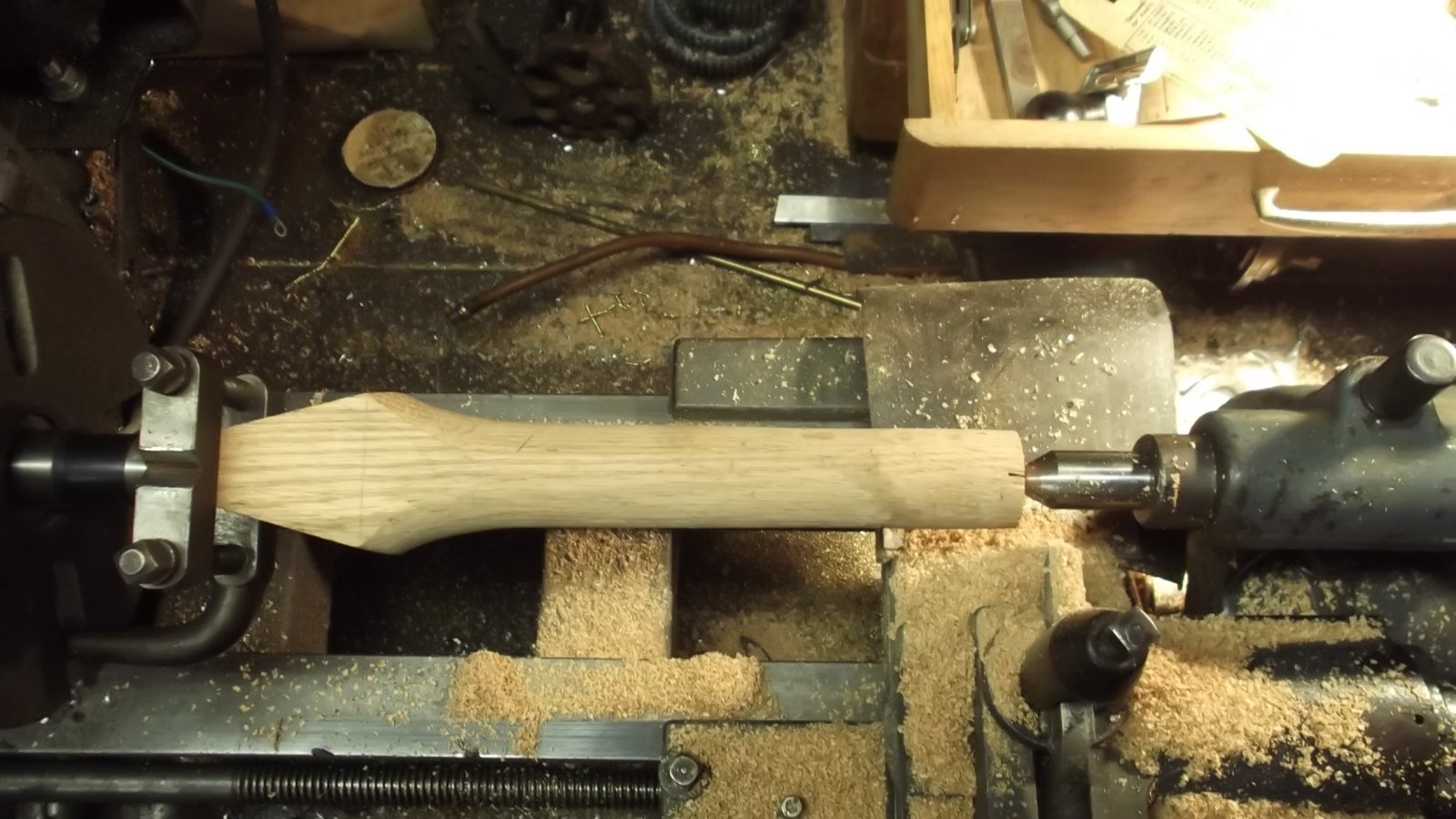

Marking the end;
Set up in lathe to cut tenon;
Cutting the radius;
Re: My ebay spokes making tenons and cutting radius for center
Posted: Thu May 09, 2019 12:45 am
by Mark Gregush
Radius cut;
Spokes ready to install;
Trimmed the tenons to length and cut for radius on hub with back saw.

In the day there were tenon cutting tools, there were two components, the first tool cut the taper and the second tool cut the tenon. It would take about 15 seconds to do a spoke. The depth and diameter was set so they were all the same. The photos are the first component that cut the taper, tenon cutters are available at quality tool stores.

While I don't the the starting cone I do have 2 tenon cutters. The problem with them is they only cut to X size. While you may have 1/2 or 5/8" tenons, they really are a bit larger for crush and the cutters don't leave a fillet at the bottom as needed. Other issues with the ones I have were; diameter of stock, age of wood and dryness.
In any case the 2ed wheel was a flop. My fixes made everything worse. Too much to going to typing it down, but lessons what not to do for future.
