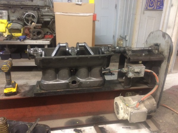

Please show the set-up you use to run your shaft in.

I blue/scrape any high spots and use Timesaver to set my rods and crank.
Re: Burnishing?
Posted: Thu May 09, 2019 10:40 am
by D.Yoder
Timesaver run in
Timesaver run in

Burnishing or running in is not necessary if the surface finish and dimensional tolerances of the crankshaft and main bearings is good.
“Running In” as Ford specified was to correct the fits and tolerances in case the machining was sloppy. In most cases it was. The act of “liberally oiling the bearings and running in the mains until the bearings smoke” was to provide a fairly precise fit without high precision measuring, without high precision machining, and with only a moderately skilled mechanic doing the work. The temperature that the oil smokes at is the temperature that the journal has expanded enough to provide proper oil clearance once everything has cooled.

i guess i could use this!!!!!!!!!charley
Re: Burnishing?
Posted: Thu May 09, 2019 6:43 pm
by D.Yoder
Charley I like it more pictures please :D
Re: Burnishing?
Posted: Thu May 09, 2019 6:56 pm
by HornsRus
ok.charley
Re: Burnishing?
Posted: Thu May 09, 2019 8:35 pm
by Adam
Where is it? It needs to go to the Model T Museum!
Re: Burnishing?
Posted: Thu May 09, 2019 9:56 pm
by HornsRus
don't worry about it it is in my museum.ha ha. charley

scrap maybe not,as i have been offered $5000.00 for it.oh looks like sandblast and go to work. charley

How is it driven? is it flat belt on the drum or are the inturnals of the drum an electric motor?
This diagram shows the complete engine has a fuel line, is the engine being driven or for driving?

it is run off line shaft,but motor can do the work, also motor can be started with it. charley

If the engine was driving the crank in the bare block as shown in the picture, it would be turning the crankshaft in the wrong direction.

Found an original ad, my question answered, for running in the complete engine as well, neat tool wish I had one :cry:

kerry i saved mine from the scrapman 30 years ago at an auction for $60.00.maybe you will get lucky to.charley

After I finish line boring I burnish the Bearings to the crank with time saver in the same setup.
