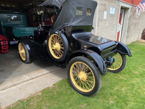

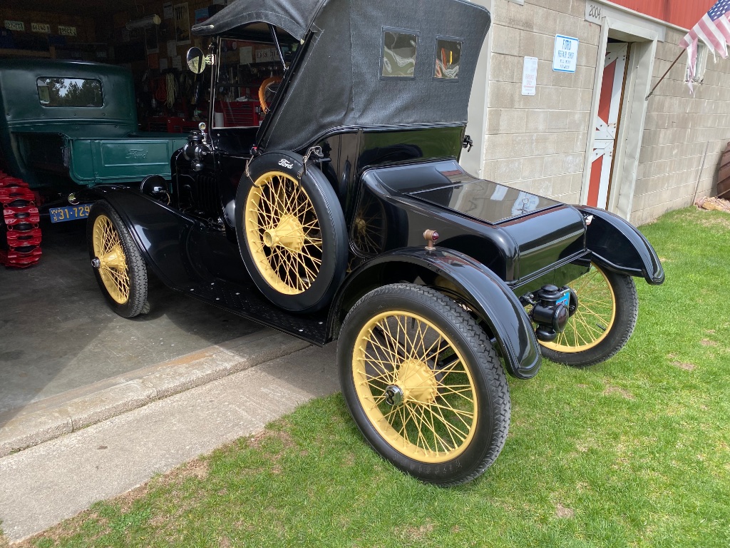

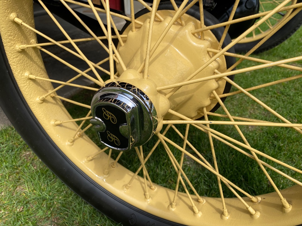

Does anyone have any information on 30x3 1/2 Budd wire wheels. I have them on a 23 Roadster and had my drivers side rear loosen up on me. The hub cap is a heavy nut and holds the wheel on the hub. Drivers side is threaded normal, passenger side reversed like the spindle bolts. Have I got that right? There is a special wrench that pulls a locking pin on the hub that keeps it from spinning. Any information would be helpful.

Its good practice with any quick demountable wire wheel to check the hubcaps for tightness prior to an outing.
I have a wheel center listed in the classifieds if you are in need of a spare.

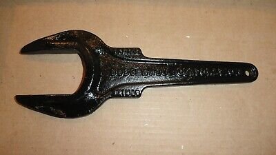

Yes, there is a special wrench:
budd wire wheel wrench.jpg (16.34 KiB) Viewed 6590 times

I have the wrench, I have had the assemblies all apart, I just replaced the babbit thrust washers in the rear end after they crumbled, but that is another subject. I am wondering if anyone out there has some original instructions? Not much useful information in search engines these days.

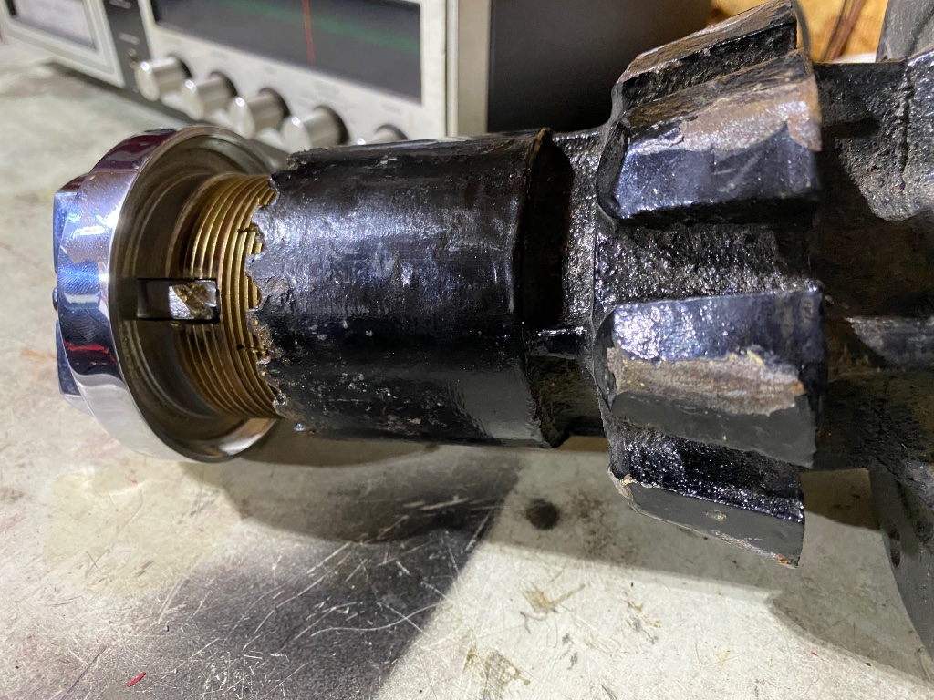

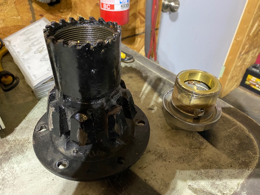

Here is the wheel that gave me problems and the parts of a left thread rear hub and hub nut. You can see the locking mechanism for the hub but.

I can also see that the hub nut has been bored out and slit in several places thru the thread. Then a ring inserted and soldered into place to reinforce what was no doubt a collapsed hub nut with bad threads. Not to say that this repair was not sufficient, but very likely the hub has similar wear and/or distortion of the internal thread.
I would start by measuring and comparing all your hub nut thread sizes with thread wires. Overtightened hub nuts can crush and reduce their diameter.
Also measure the diameter of your hubs on the outside of the threaded barrel section. If the hub nuts are overtightened the hub material can yield and increase it’s diameter. This effectively wears out the thread in the hub

That hub and nut are spare parts, not on the car. It seems these parts are not very common and there is little knowledge of their use. Perhaps they are worn out. I agree with you Kevin, that they can only be tighten so much. Another problem is the way the wheels actually fit on the mechanism, they are very difficult to tighten and I see no way to shim them. I may have to switch to Ford wire wheels.
These wheels are not relatively uncommon (for hens teeth). There were a lot of Overlands, and many sets of these wheels were saved because they are an “easy” adaptation to a T. I’m sure that parts would surface if you needed them (similar to Dans wheel center).
What is the issue with how the wheels fit to the hubs…? The Budd wheels have a very common design principal, two opposing conical surfaces provide repeatable concentric alignment for the wheel center. One of these cones is removable (hub nut), the other is oddly shaped to double as the drive mechanism (hub).
Common issues with quick demountable wheels is the wheel centers can stretch or hubs can collapse, allowing the wheel center to bottom out on the brake drum. If this happens, the wheel center will not seat on the inner drive cone and allow the wheel to wear the hub and even break the ratchet mechanism on the cap. A stretched wheel center can typically be identified and used as a front wheel reliably. Be cautious of the hub nut running out of threads too, have seen this more than once. If all of the components in the system are “good”, the ratchet mechanism is unnecessary.

What is the best way to convert Overland Budd rear hubs for use on a T?
Joe Reid
Posts: 270
Joined: Thu May 23, 2019 12:21 pm
First Name: Joe
Last Name: Reid
* REQUIRED* Type and Year of Model Ts owned: 1919 Coupe, 1920 Roadster, 1923 Touring, 1924 Roadster, 1913 Racer
Location: Almond WI
Re: Budd Wire Wheels
Post by Joe Reid » Thu May 04, 2023 11:45 pm
I believe they welded T Hubs into the Budd hubs.
frontyboy
Posts: 499
Joined: Tue Jul 23, 2019 3:16 pm
First Name: dick
Last Name: dock
* REQUIRED* Type and Year of Model Ts owned: T sprint cars
Location: locchoy wa
Post by frontyboy » Fri May 05, 2023 1:56 am
If you can get a inside hub for a wood wheel that has the axle taper and key way, you can fit it inside your wire wheel hub. You might have to machine the diameter a bit to press fit it then weld it around the perimeter for safe. Presto you have a modified hub for a direct fit to a model t axle.
Now if your using Budd Overland front hubs there is some easy machine work to do. Overland bearings are larger o/d that model t. I machine a dutchman to allow a model t bearing to fit snugly in the rear of the Overland inner wheel bearing. You will have to do the same on the outer bearing. For those of you not knowing what a dutchman is, machine a ring the diameter of the o/d of the hub(inner wheel bearing) once pressed into the hub then machine the inner diameter lightly press fit the inner wheel bearing inside the dutchman.
On the outer bearing you need to machine a spacer to put the front wheel bearing out on the model t hub. This will allow you to use a threaded inner bearing and the front spindle nut and cotter pin. there are several different sizes of Budd hubs for 30x3-1/2 wheels so do your home work first.
frontyboy.
Aussie16
Posts: 281
First Name: Warwick
Last Name: Landy
Post by Aussie16 » Fri May 05, 2023 3:14 am
Really enjoying this thread. I have had a set of Budd parts for years. Have just committed to have the outer hubs laced into new rims. I am fortunate to have the correct front hubs to suit the Model T but the rears are Overland and will require the Model T taper to be installed inside the larger Overland taper. I do have one original rear T hub which I would consider selling to fund the machining work on the Overland hub? The T and Overland rears are different in shape with the Overland inner being round and the T one a Star shape. Looking forward to having a full set now that I have a plan. Wish my caps looked as fancy as the ones on that neat looking runabout.
Posts: 7299
Post by Allan » Fri May 05, 2023 7:25 am
I have bored out Hayes hubs with flogged out keyways, and pressed in machined down T hubs with good tapers and keyways. These require a step in the hub and on the donor piece fitted. There is not enough "meat" in a Hayes hub to allow machining a single diameter for the T hub centre. These are a press fit and are scotch screwed once pressed home. There has been no need to weld them, but it should not be a problem to do so.
