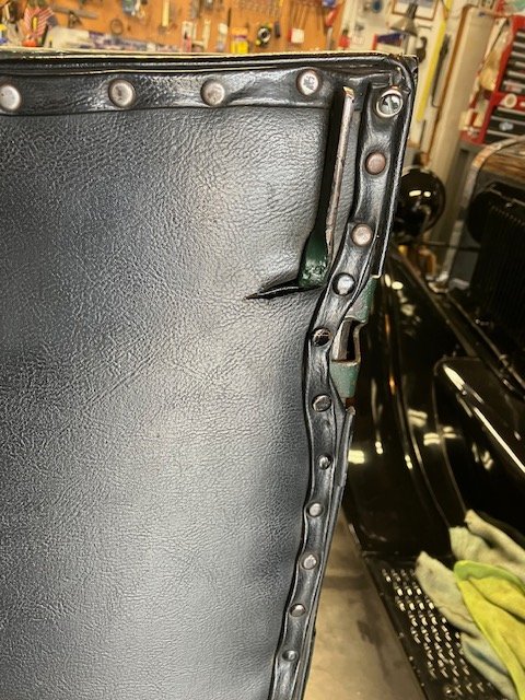

Mark: When I restored my 21 Touring back in 1970, the kits had the same carboard door pannels that I knew would not last. I made my own using some heavy cardboard poster board. I first covered in a thin foam (3/16") using a spray on upholstery glue. I then covered the foam with black vinyl material, wrapping it around the edges and again using the spray on glue and a more permanent glue where it wrapped around to te back. I tacked it on using a vinyl upholstery trim. For the part that goes around the edge of the latch, I continued with the same trim, using short round head paper fasteners, painting the head black. I just cut a slit for the latch handle, no trim. This has held up quite well over the years. This car is used a lot and many kids have climbed through these doors. this is a picture of how it looks today. Hopefully this will give you an idea for your car.

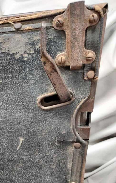

Mark, these are pictures of the original door panel on my 1924 runabout. There are two metal trim pieces.

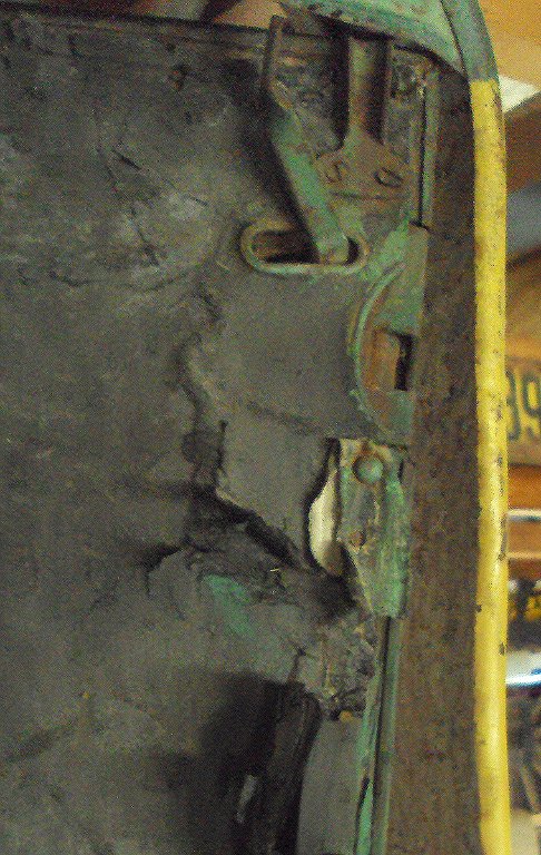

Pictures on this discussion support those shown:
https://www.mtfca.com/discus/messages/5 ... 1433642698

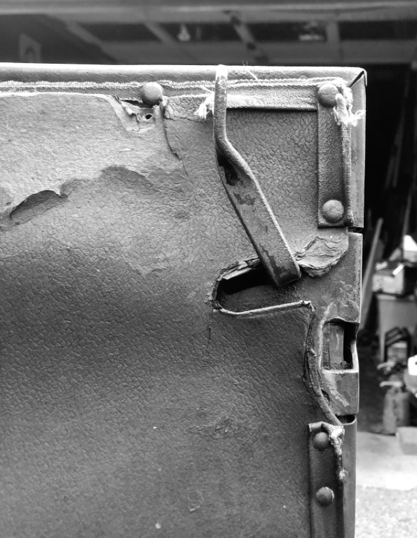

I have a NOS cardboard door panel, as I recall it's for a late touring. What I see happening is most likely the new grained cardboard available is thicker than the originals. About ten years ago, I restored a 1925 roadster with all the proper reproduction hardware. It has all since come off just driving on a few tours. I believe what needs to be done to correct this problem is to correctly put bigger tabs on the backside of the two pieces so they will stay on.

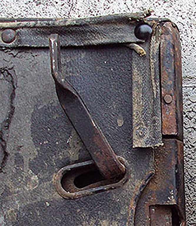

Post by Rich Eagle » Mon Aug 07, 2023 12:50 pm
Here is another photo of an original. Not the best photo but it shows what was there.
