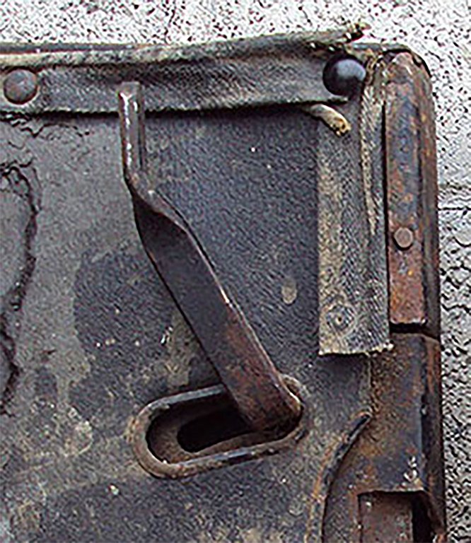

The interior door panel on my 1923 runabout is falling apart from use. As most of you know it’s a dense black cardstock base covered with a thin textured outer paper skin very much like that used in musical instrument cases, camera bodies etc. There is a oval cutout relief near the lock assembly that is trimmed with a thin steel edge. My question is … was there a similar steel edge on the oval hole for the release? Does anyone have a complete panel in good condition as a reference?

by Humblej
Mark, these are pictures of the original door panel on my 1924 runabout. There are two metal trim pieces.

by John kuehn
As far as the spacing distance between the panel tacks are concerned it’s close to the distance as what’s shown in the two original panel posts on this thread. I have a 21 Touring and I checked other cars from the same era and none are exactly alike. Eventually I made the distance around 1 1/4”.

by Rich Eagle
Here is another photo of an original. Not the best photo but it shows what was there.
