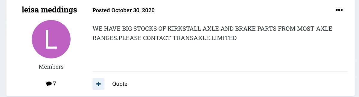

These posts are a few years old but the business is still going.
