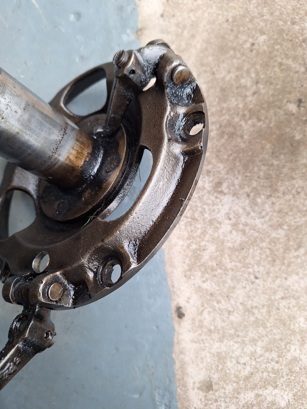

I have taken my transmission apart to try and solve the issue with my brake band, hopefully someone can advise me on what I have and the best way forward, I believe my drum is a wide drum which has been machined in to a narrow drum but then they have used the drive plate off the wide drum, can the narrow drive plate be made to work with a modified wide drum?

Your drum isnt necessarily a cut down wide drum. It looks like the late narrow replacement drum that did come with shoes. The drive plate would have the lip like the pre 25 plate, but with a slightly different bolt mounting pattern. That lip was actually part of the drum's lining surface.

Do you have a picture of the brake band itself? Have you closely inspected it for any cracks, including where the end lugs attach?
Your drum appears to be fine. You just need the proper drive plate. Is the outside diameter of the drum, (where the brake band rides), straight, and not tapered?

OK, now it can be seen what has been done, the drum is an 1925 narrow band and fitted shoes, a rare drum, if it was a wide drum turned down, the number on it would be T-709-B The T-709 is the narrow drum number, The drive plate is a wide drum one that has had the bolt holes over sized to try and marry it to the drum, remedy is to find a small drum drive plate.
