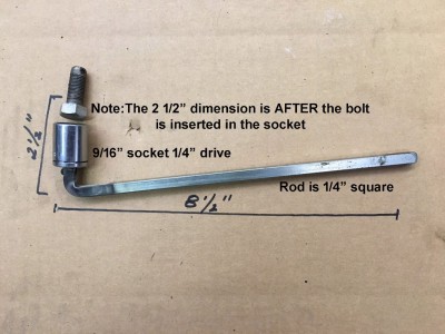

by Bill Robinson
Here is a tool that I made for doing the same thing. Really works good.
    1. Line the holes up.
      2. Slide the both up through from under the frame rail.
        3. Hold the bolt in place with the square rod.
          4. Get the nut started and tightened to your specs.
            5. Insert cotter key/pin.
              6. Insert the wood block.
              Upper, rear motor mount bolt holder
