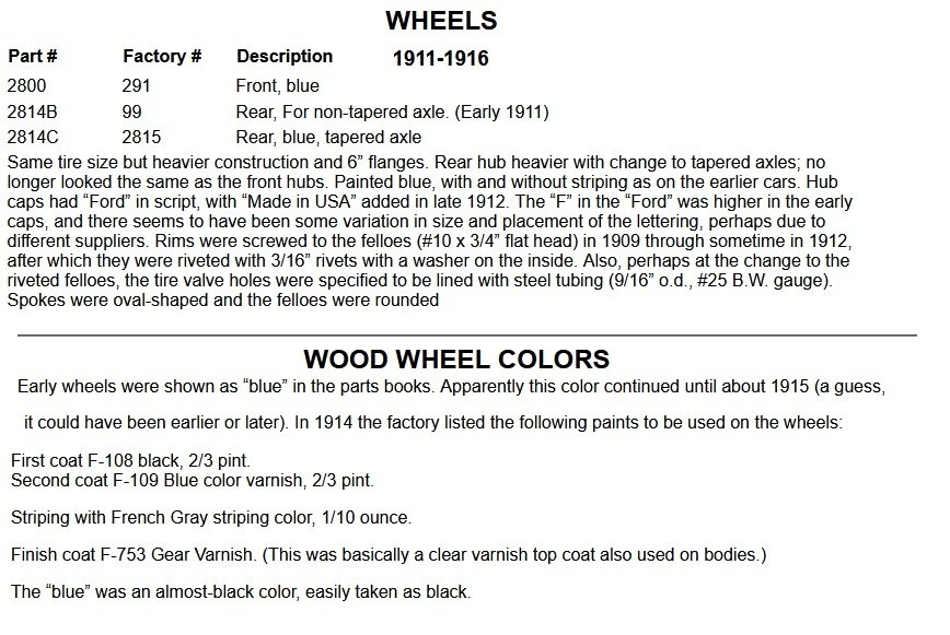

To answer what is correct- note "blue" was almost black
from https://www.mtfca.com/encyclo/P-R.htm#paint1 on paints
Another interesting dip painting operation was the painting of wood wheels. The first coat applied was F-108 Black Wheel Surfacer. This paint was primarily made up of pigment (52-54%), with the oil, gum and metallic dryer representing 12-14% of the paint, and a thinner of mineral spirits which accounted for 32-34% of the paint. Unpainted wheels were mounted horizontally on a vertical spindle above a circular vat partially filled with paint. The vat was raised, immersing the wheel in the paint and then partway lowered. The wheel was then spun at 540 to 720 rpm for about a minute while still within the vat but above the surface level of the paint. After spinning the paint was considered to be dry enough that the wheel could be handled and it was placed in a drying room for the next 24 hours. The subsequent two coats of paint were applied in a similar manner. The second coat was F-159 Black Wheel Color Varnish. This was followed by F-404 Finish Coat on Wheels. F-404 could be described as a nearly clear topcoat varnish. It contained only enough pigment to give it a dark tint. This painting process resulted in wheels that were a deep, gloss black color.
NOTE: The above does not mention F-109 as the process below includes it and the codes for "Gear Varnish" are different
