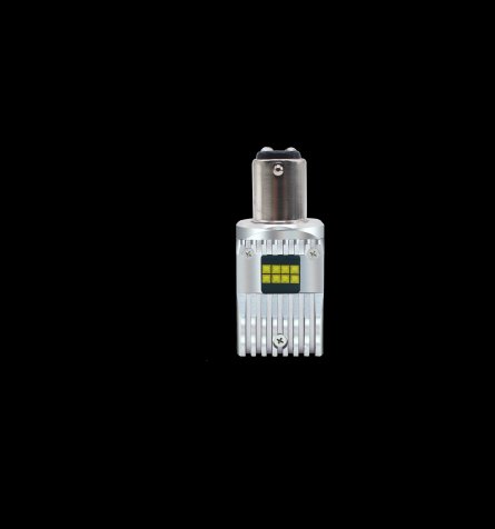

I've tried to types - first this type:

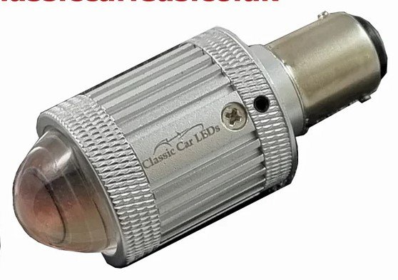

and now lately this one, that is selfcontained with optics and all:
I've tried it in two different vehicles. In both the high bean worked flawlessly, but the dim did not work or worked "spooky". The latter that I'm trying now the one of the two bulbs light up very dim. when I take the bulb the light out, the other one starts lighting up still dim.
With traditionel bulbs it works OK.
The LED bulbs supports 5 - 30 V pos or negative earth, so it can't be because I have the worng type.
Have any of you any experience with these sorts of bulbs?
The high bean have a fantastic warm white light, so it is definately something to aim for in a T driver.

I found ta WEB site for your bulbs https://www.classiccarleds.co.uk/produc ... nd-pattern
Did you see this in the instructions?
-These are NOT suitable for AC systems. so will not work on MAG
-When fitting the lamps, ensure the black centre line is at the top of the lamp. An Allen Key is provided to allow you to adjust the beam so that it is level by undoing the 2 grub screws, carefully rotating the head of the lamp slightly until you reach the desired level and re-tightening them. Please take care not to over twist the LED and damage the internal connections.
-12 month warranty on this product.
The ones I found appear to have the same housing but different specifications. The specifications are not stated as those of the bulb but to fit Model T or Model A cars. Also what type of bulbs were the traditional ones for battery or for magneto. What I don't see mentioned, specifically, if these are considered double filament bulbs (think two sets of leds) or they have 1 set of leds and the low beam is controlled by resistance. You may have a bad bulb(s).

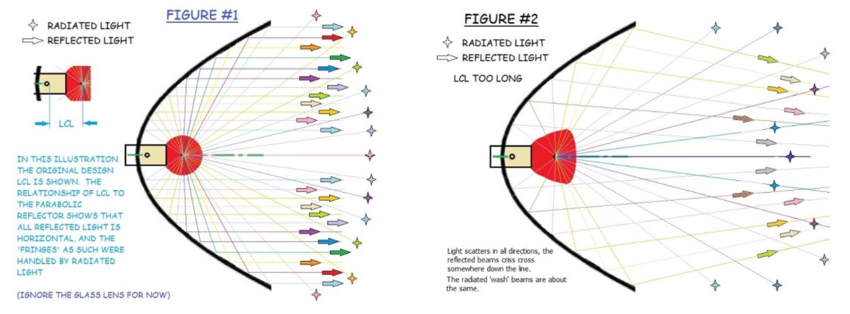

The issue with led bulbs is that do not disperse the light from the reflectors focal point hence the lens looks brighter when you look at but the light projected from the headlight lens isn't as good as it can be & is less focused. But still looks better than traditional if a high temperature bulb is used 6000k --
This diagram shows how the light gets dispersed to the lens. It is the lens (the fluted style lens of the Model T) that focuses that light ahead onto the road. Again t just not as efficient as it can be --
The expected light pattern from traditional style bulbs
