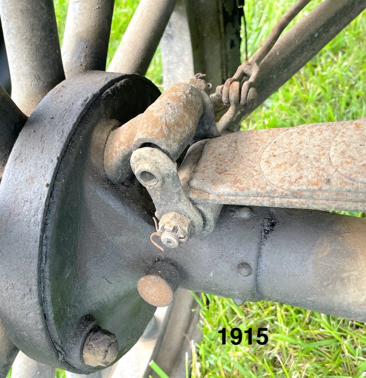

What was the final year for the domed head clevis pin? Both my 1913's have them, and Russ says his 1915's do too. So, how much longer did they use them? Langs catalog incorrectly says they were used until 1911.

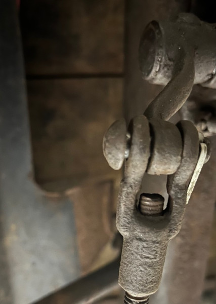

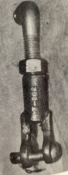

Here is a parts list art of the 2564 hub(brake rod) clevis pin (qty. used per car 4), from the Sept 1912 Parts list. Hard to tell if the head is high dome, but Lang's catalog shows a rather high dome and regular lower dome like originals, on page 30. (2564E part #).
Early cast end brake clevis pic shows a likely high dome head clevis pin.
Very nice original 1915 at Luray swap 2022, clevis pin seems to have higher dome height head.
Haven't restored an early T, so never seen a 'high dome pin' in person. Here are typical 2564 clevis pins and a repro.

Interesting is the early 1909, with two-lever and just after the 3 pedal used a 'flat thin head' clevis pin for the Speed lever control. Here is view of two-lever, the part #3433, Factory Number T-898 (qty. used per car 1). Later parts books don't list the #3433.
Also, the Clutch Lever clevis pin, part #3411, Factory Number T- 857 (qty. used per car 1), was in the 1920 and 1924 and later Parts Books, notes to just order #2564, the brake clevis pins.

The Luray photo is it! However, my question still hasn't been answered! Maybe someone needs to check the record of changes for that number?

My original touring was built in the beginning of the second week of June 1913 and it has them.

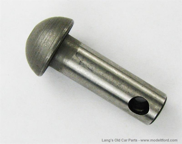

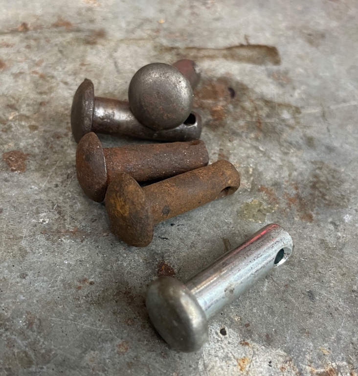

We used to sale a round head clevis pin like in this photo but the gentleman making them passed away. It was not really even domed at all.
The clevis pin you are looking for is an intermediate height head between that one and the later style.
Thank You Steve

Steve: The photo you posted is it. Your catalog incorrectly states they were only used until 1911, which is not correct. I still see no information as to how late they used this domed head style!

The Lang clevis appears to be a modified solid dome top rivet. Very easily doable.
However, The Luray picture shows a larger diameter head. Modifying a solid rivet wont be quite right.
Looks like modifying a bolt head would get closer to correct. Doable, but much more work.

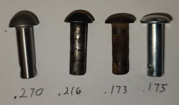

The round head pins we used to sale were from Otis.
They do have a taller head than a Pin out of a Early 1912 touring car we got. Its a nice unrestored car show in the photo.
I'm sorry I don't know if there were even more styles than these and I also don't know dates of changes.
In the photo is the Repro Otis pin, early 1912 Pin, Later pin, Reproduction pin. The measurements are the height of the heads.
