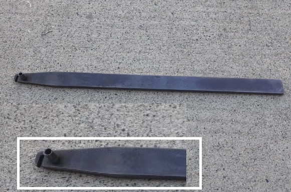

I believe this is the tool for 1926 springCatGuy wrote: ↑Mon May 22, 2023 8:09 amI noticed that the left rear drum on my '26 Roadster felt warm after a short drive. I took things apart yesterday and noticed that the previous owner goofed when he put the shoes on and of them was riding on the outside of one of the little tabs. While I was removing the spring it broke. Ordering new ones today. I've done brakes before on /modern' cars from the 40's, 50's & 60's. Is there a special tool I should be using? Is there a trick to this?

- brake tool.png (273.04 KiB) Viewed 1051 times

Nice! Wish I had that!TRDxB2 wrote: ↑Mon May 22, 2023 9:57 amI believe this is the tool for 1926 springCatGuy wrote: ↑Mon May 22, 2023 8:09 amI noticed that the left rear drum on my '26 Roadster felt warm after a short drive. I took things apart yesterday and noticed that the previous owner goofed when he put the shoes on and of them was riding on the outside of one of the little tabs. While I was removing the spring it broke. Ordering new ones today. I've done brakes before on /modern' cars from the 40's, 50's & 60's. Is there a special tool I should be using? Is there a trick to this?
