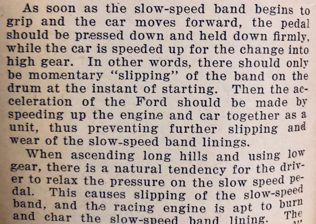

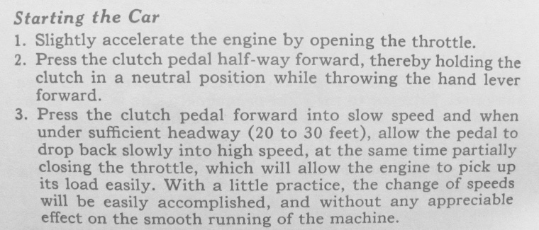

Re: What’s the trick to a smooth transition between low and high gear?
Reno Speedster wrote: ↑Tue May 23, 2023 6:06 pmShould I be feathering the shift like you do a normal car clutch? Should I be doing it briskly?
Just use the Ford instructions in the owner's manual. After experience you won't use the hand lever, but throw it forward and hold the low pedal 1/2 way for neutral and begin your underway. Travel about 20 feet or so, in low, perhaps up to 6-8 mph, then release low pedal to high the same time you throttle down, and then throttle back up as the shift happens for smoothest transition to high.
Made a YouTube video of my shift to high after a bit of repair for a low speed growl.
LINK to Video
https://youtu.be/AJZ8VLPtslQ
Added good info from the Ford guru Murray Fahnestock:
