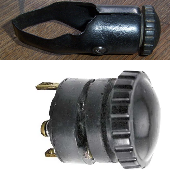

Planning to use the column mounted horn combo light switch for a horn & turn signal switch. Have the switch and several casings that mount on the column. Used pictures from the Internet. Haven't taken any of mine yet.
light switch.png (366.28 KiB) Viewed 1671 times
Also to use taillights (like the drivers side repro) with an amber bulb dual filament bulb (led). Will point the license plate window outward for visibility to traffic on the left & right. The center bolt makes easy mounting, Some rerouting of the wire connections will be required,
