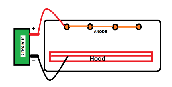

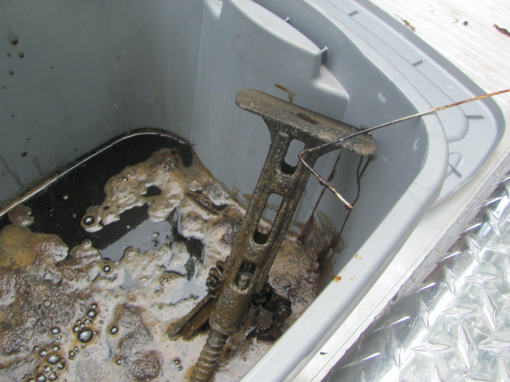

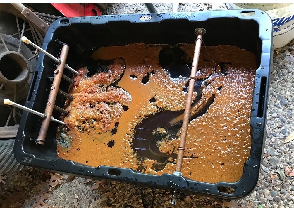

You might try an electrolysis tank, its easy to make and its known to also get the rust out of internal surfaces. One hinge at a time. I had a door latch that was rusted internally and no amount of WD40 etc got it loose - the tank did can't find the picturesfschrope wrote: ↑Thu Jun 22, 2023 9:37 pmThe Subject line says it all.
I have several low and high hoods that have the hinges rusted enough that they bend the tabs.
Any solutions?
I know - penetrating oils of some sort, but these are past that.
I've thought, but not tried, putting a wooden block on the back and hitting the top with a mallet or such. I haven't tried much yet.
Ideas??? Fire away, I'm all ears.
Here are some instructions https://www.secondchancegarage.com/publ ... emoval.cfm
I made one using some rebar as the sacrificial anode, You only need about 1/3 cup washing soda for each 5 gallons of water or 1 rounded tablespoon of soda per gallon. Too much is not a good thing - can burn at the charger , which needs to be a manual one not one that auto shuts off when the battery is charged - a dumb trickle charge will also work

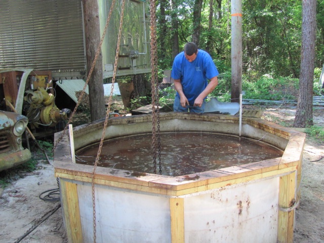

- Posts: 4080
Re: Stuck/rusted hood hinges

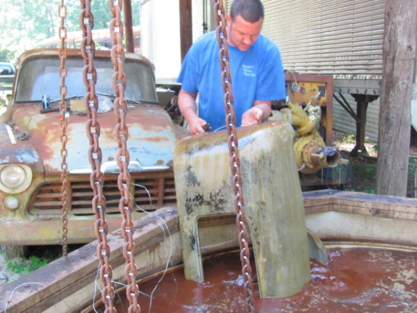

Simple, safe, and effective for your rust on those hood rods.
Molasses and water
Just get a 1 gal. of molasses and a shallow plastic tray, long enough for the hood length. Soak in a 1 gal : 2 or 3 gal. solution of water and in a few days the rod will be free of rust. Have used this method for rusty hood panel with stuck rod, after apart, sanded the rod and coated it with Slip-Plate, the graphite paint, hood raises easy and no sticky ever again!
Molasses and water
- Posts: 6573
Thought about Molasses to but never had the ratio of molasses to water. Also GREAT IDEA of slip-paint on the rods !!!!!!!!!!DanTreace wrote: ↑Fri Jun 23, 2023 8:19 amSimple, safe, and effective for your rust on those hood rods.
Molasses and water

I ran a test to find the optimum Molasses to water ratio, using glass jars and rusted rod. The best results were using molasses at 40% of the volume of the mix. Less molasses was slower, more made little difference. I can't guarantee that all molasses is of similar make-up. Feed grade stuff, conveniently packaged and nicely labeled, is likely to be mixed/diluted for consistency. Mine was as it came from the sugar mill. It is the one process in my workshop that my wife's heightened sense of smell is not offended by!
- Posts: 7243
Re disposal of the molasses mix, being a plant based organic product it can simply be poured on the ground and allowed to disperse, with no detrimental effect.
- Posts: 4080
The mix ratio can vary, first tried 2:1 water to molasses, 1:1 seemed too thick. So yes, mix and temp are considerations.
But net effect, sure is great at rust removal, safe for operator and the environment. Got the first idea to use from a visit to a hot rodder friend, who rebuilds for others too. His tank is huge plastic, and with chain falls over, can lower in large parts at a time.
And works on fine delicate items too
