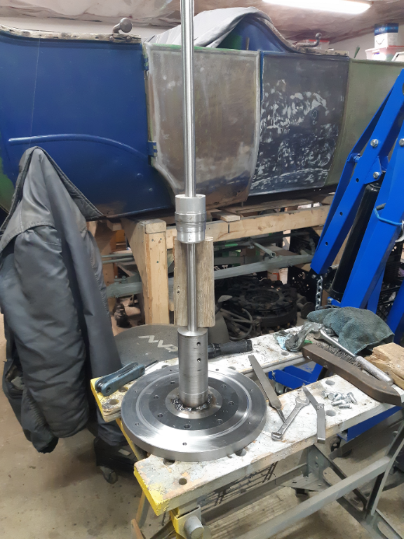

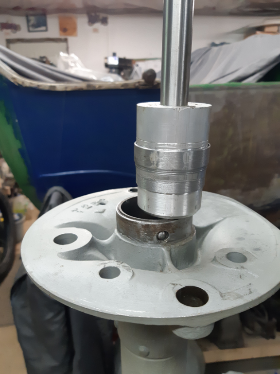

With a friends with a good size lathe we turned a baseplate and added a core pin to mount the axle housing based on one shown in a past posting. I also bored the center plug for a drill rod to be able to use the jig anywhere. The drill rod is held in place with two set screws too to keep it still and straight. This way the jig can be used on either a large lathe or on table if you don't have a lathe.
I have two pair of housings, a 13 pair and a 14 pair which I checked first by trying to assemble the rear end, but only one outer bearing would go on. So an indication of alignment issues with the housing. When placed on the jig, all 4 showed up as bent. The one that the bearing fit in was the least bent. The bending is measuring out between .100 to .300 inches so some work is needed.
Now for the main question. To those who have straightened these housings before. How hot should the tube area be heated and how to straighten it out. Can this be done by heating and chilling with water to shrink the "long" side or would you heat red hot and pull it into place.

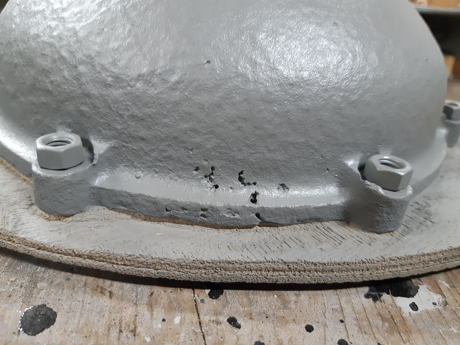

Some pictures below of the jig we made and an example of the bend found in one of the housings. I also have one very rusty housing that has been bronzed up to try to seal the leaks that can be used for practice before trying to straighten the good ones.
Side note. Out of curiosity I also pulled a later style rear housing and tried it on the jig for comparison. The alignment plug dropped right into the outer bearing sleeve so it was straight, or at least straight enough.

I'm in the process of rebuilding the rear axle for my '13 touring project. I have read through some of the past postings about issues and fixes for the 12-14 rear housings. So far I have taken the tubes of the centers, cleaned and re-attached them. I ended up with a hybrid of two suggested methods for re-attaching the tubes to the centers. The old rivets were removed and I found that most were not very tight in the hole even though the ends were well squashed at the factor. So I used a hybrid method to put the parts back together. Stove bolts with sealer between the parts for the main attachment. These can be tightened solid to hold the tube to the housing. But there is some play in the holes and bolts. So I used two solid rivets hammered in place opposite one another at the middle line. These to act as dowel pins to ensure that the tubes cannon move around the centers under braking and driving loads.

Your vertical fixture will work well for the job. Leave the housing on as you work & check progress with every quench.

The large spigot in the middle of the flange is turned to be a slip fit in the inner bearing sleeve hole in the center housing. The center casting can be alignment checked by placing it over the pin and checking with a feeler gauge around the bolt flange where it meets the gauge flange. The gauge plate is also drilled for bolts so that the housing can be direct bolted to the base when working on. Each of the 5 housings that I tried on the jig all fit well against the base flange when slipped over the gauge pin. So, although there could be some miss alignment of the center casting, its likely about “as good at the factor made it”.
And interestingly, all 5 housings appear to be “bent” in the same general direction. Slight “ahead” and mostly “up”. So, it suggests a combination of overtightened radius rods and lots of weight on the rear end when driving.

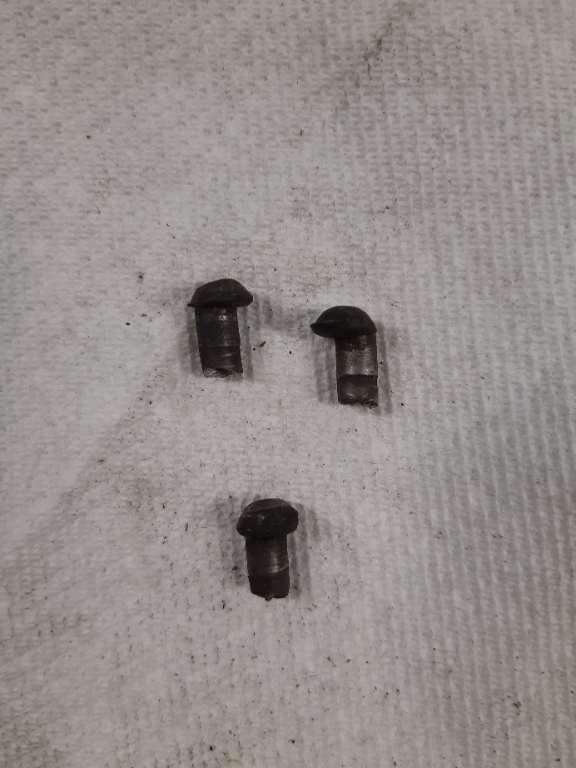

I spent some time thinking about rivets vs bolts for this application. One of the projects for this T was to re-rivet nearly the entire frame where someone had removed many of the rivets and installed the wrong later rear cross member. I did a fair bit of rivet research and experimenting. I do believe that Ford, or more correctly the suppliers cold riveted the frame and most parts using specialized jigs and hydraulic rivet presses. Smith Brothers who made frame for many of the early, and later manufacturers used this method. To get good clamping pressure between the two plates requires a lot of force. Placing two plates or parts together and installing a rivet and hammering (or even heating and hammering) may spread the rivet in the hole, but is not a guarantee that it is providing a good clamping force for the two parts. I tried several test pieces using a 10-ton hydraulic press, plain hammering, and heating and hammering. In most cases, even with good looking rivet heads, the two test pieces could be wiggled as the clamp force was low. When re-riveting the frame rivet jacks were used as much as possible to help with a pre-load clamp force and then the rivets were heated and hammered. And even then, 1 in 5 had to be re-done to be really tight.
General comments.
When I took two of the housings apart it was obvious that these rear end rivets did not have good clamping force unlike most frame rivets. When removing frame rivets, I usually have to drill most of the way through then use a punch and hammer hard to get them out, and they are hard to get out. When removing the rear end rivets once the head was ground flush, the rivet could be easily punched out with a drift. They were NOT tight from the factory. And see the picture below of some of those removed, many were not even pressed squarely from the factory. The shape of the rivets showed that they were pushed in from the outside and then pressed on a fixture to mushroom the inside end of the rivet. And most were not even close to being on center.
Bolts can be torqued to produce more consistent clamping force, but don’t spread to hold the parts in alignment unless they are fitted bolts. Rivets work well for alignment as the spread out to fill the hole and hold the parts in alignment, but they don’t produce reliable/repeatable clamping force. So, I did the hybrid. Two rivets to prevent movement of the parts, and stove bolts to hold them tightly together. I did make an anvil jig to help with the riveting which made it go surprisingly easy in the end, but the two main parts could not be pre-clamped together so relying on the hammered rivet only for clamping force didn’t satisfy me. A picture of that jig is also attached for information.
And I would comment that this era of Ford rear axle was not very well built by the supplier. The design uses “sloppy” fit tolerances by most modern standards. And the center housing castings are not very good either. Lots of bubbles and voids in portions of the outer sides of all of them. I expect that under modern quality standards nearly all of these castings would have been rejected at the factory. Most of these defects couldn’t be seen until they housings were sandblasted. And there is a range in the quality and every one has some level casting imperfections. Mostly on the outside at least, the insides appear much better. A picture of one of the worst examples below.
General comments.

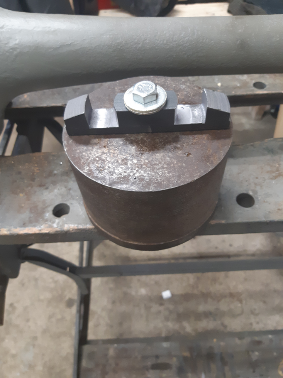

Jeff, my 1912 clamshell castings were cracked between the rivet holes. A very neatly formed crescent shaped backing piece was riveted inside to back up the replacement rivets. Welding up the cracks distorted the two castings.
The spiggot I made to fit the bearing bore was of two diameters. To machine the mating surfaces between the castings,and dress the thrust faces, a smaller diameter passed through the centre so I could mount the castings mating flange outwards. Then the tool was reversed in the housings so I could true up the outside lands where the tubes riveted to the housings. Perhaps this was an un-intended master stroke, because when the tubes were bolted to the castings, all was in order as far as straightness goes.
I bolted the pieces together. The bolt heads were machined to match rivet heads, the inner end of the bolts was slotted so a screwdriver would hold them when running the nuts up. I used a red Locktite non hardening flange sealant around the castings and tube, the bolts, and around the outer land on the castings and the flange on the tubes. That was in 1995, and it has not leaked at all, yet.
I hope yours turns out as well for you.
