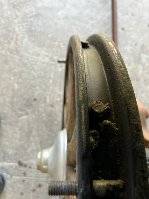

My son and I changed the tires today. Someone requested that I post a picture of the edges of one of the rims after the tire was removed. Here are the pictures:
When we were pulling the rims off of the wheels we noticed that on the front wheels the ends of the spokes looked like this:
and the rear wheels looked like this:
Is this how it's usually done?

things look to be in remarkably good shape
you will find on that one front wheel that what you think are spokes protruding (round) is really just steel dimples in which the spokes have little short tenons simply smooshed into them. If what I say is true, then personally I would take a very close look at the other 3 wheels, take good photos of them and then try to find a 4th wheel just like them (where the tenons go all the way through). Beware that there are multiple versions of "correct" wheels out there so be sure to replicate the style you have
as far as clinchers, the clinch part is about as good as you are EVER going to find on a demountable wheel. You are one lucky fellow!

I cleaned and wire brushed the insides of the rims, but did not paint them. I had my son helping me (or maybe it was the other way around) and I got into "get it done" mode.
Both front wheels had the dimples that the ends of the spokes fit in. Both rear wheels had the spoke protruding through. What should I do to check that the front wheel spokes are OK?

I'd put tires on the rims, the rims on the wheels, the car on the ground, and then pinch a thumb and index finger together such that they are pinching tightly around/against the spoke AND the felloe (at 12 o'clock) and then give a mighty heave with the other hand on the tire (at 12 o'clock) and see if there is ANY movement between the spoke and the felloe as detected by finger tips. Then rotate the wheel and redo for all 12 spokes...you're not worrying about kingpin or suspension looseness so don't mistake movement there with movement BETWEEN THE END OF THE SPOKE(S) AND THE FELLOE.
that tests tightness/fit
structural integrity of the wood is another thing entirely and can be somewhat determined by taking the 6 bolts/nuts off, popping the retaining plate off of the spokes at the hub and going at one or more spokes with a screwdriver and determine if the cellulose still has enough natural resins to hold the fibers together or if the wood has become or is heading towards being punky. Even if good, you're going to scar some wood but the retaining plate will cover that cosmetic blemish.
Let's say, everything's wonderful...ok. Once the felloes and spokes are painted, if you ever see paint cracking at the spoke/felloe interface, don't panic, but keep an eye on things. If you ever see fine red dust creeping out from the spoke and starting to coat the felloe around that area, then that is pulverized rust dust creeping out and now when you do your "shake test" you'll probably detect movement...time for new felloes and spokes then. So if the best scenario shows good old spokes, in the mean time, keep eyes peeled for a matching set of felloes to match the rears.
