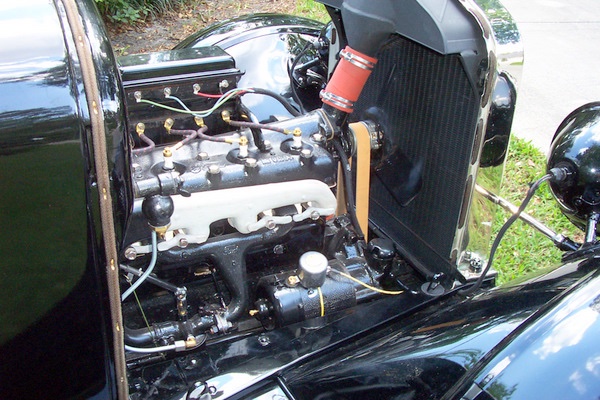

The hardwood blocks on the '26-'27 are two pieces, left and right, for ea. metal shelf.
The longer one is curved to fit the front end of the shelf, the rear block is smaller. The blocks have angled and countersunk holes for the hood clasps, and holes for the mounting bolts.
