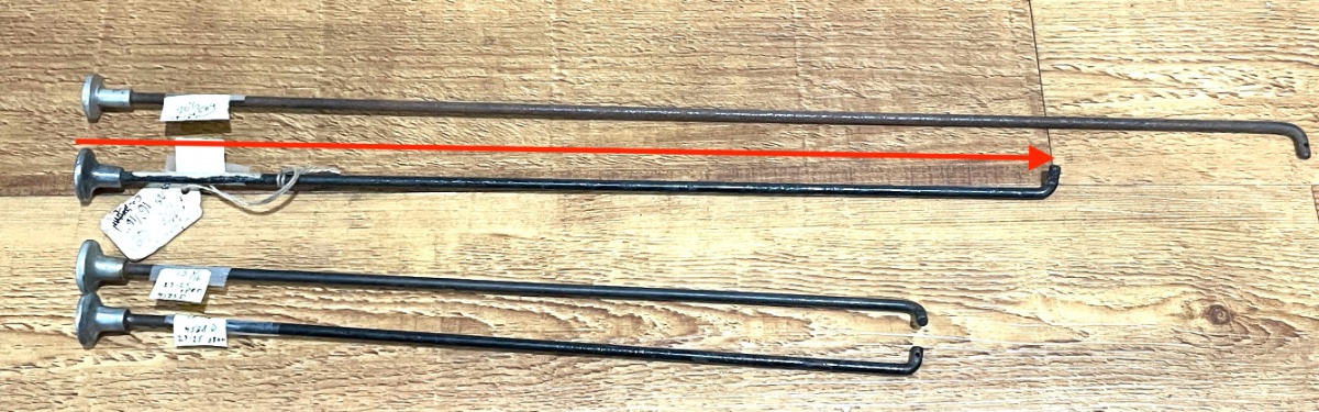

The measure is made OverAll. From top of knob to centerline of the rod. (At the bend where the rod engages the bell crank hole.)
Don't know much on repro parts, but most need some massaging to make 'em fit. ;)
Do know the #4588D factory measure is same as my measure of Overall. That is 13 1/16" overall. Right at the hole in the bend, where that is the center of the rod. Makes sense as that is the point of entry of the bend. And know that this rod fits '23-'25 open cars. (the 2 lower rods in the photo are for '23-'25 open cars.

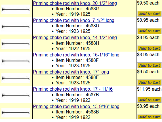

T-4588 Priming Rod, not T-4431 Carburetor Priming Rod (wire). The Priming Rod that was bought as a replacement from the vendors does not match any of the lengths listed in the Parts Price List for any of the Priming Rods, for any year/model, no matter what way/configuration you measure it. The closest it gets is to T-4588-B (1/2 inch too long) or T-4589-B (1/2 inch too short). Not to mention, the hole for the cotter pin is so far inboard to the bend its useless. I need to know what way they measure/measured the lengths listed in the Price List so I can make one the right length.
I couldn't find a reference to T-4589-B (1/2 inch too short) assume its T-4587-B)
Would T-4588-E at 17-1/8" be the one? Could you remove the knob on the T-4588-B (or T-4587-B) and shorten that end and replace the knob I think the knob is only held in place with by a Split Spring Roll Dowel Pin

This is what Langs Lists
priming choke rod w knob.png (53.7 KiB) Viewed 1229 times
