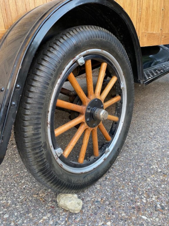

I think the Universal spare tire with checking looks better than the Blockley. It replaced a blown Blockley. I have no idea what the mileage is but I heard the owner was not happy. Perhaps just the inconvenience. Sorry about the angle but the website only takes photos when I turn my phone horizontal.

Joe,
That Blockley blew out at probabaly less than 500 miles. The clincher bead ripped away. No, the rim was not sharp. Appeared as if the bead had little to no cord to reinforce it... just soft rubber. (Not my car by the way)

It was my car with the blockley tire.Really less than 300 miles,but had used the rims with other tires for over ten years. Will be contacting Blockley today for explanation of why this happened.

So much for quality standards from Vietnam. I have heard of similar issues with their other tires also. I guess it varies by batch.
