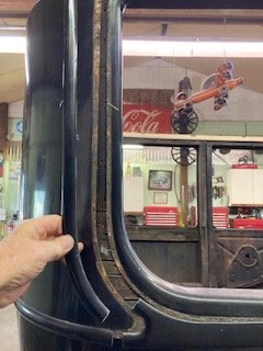

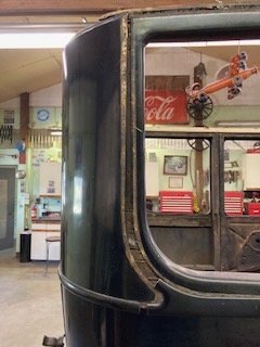

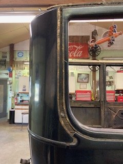

OK I have looked at the cars Don Booth did. I will refer back to his post as I restore mine. One question I have is how do you reattach the trim that is nailed on around the rear window and across the back below the window. The nails are embeded in a lead or pot metal trim. Do you drill new holes and then fill over the fasteners? See attached pictures. Is Don still here to answer questions? The body pictures are sideways. I dont know how to turn them
- Attachments
- IMG_0458.jpg (18.94 KiB) Viewed 3163 times
- IMG_0457.jpg (49.7 KiB) Viewed 3163 times
- IMG_0459.jpg (20.48 KiB) Viewed 3163 times

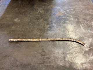

Well hear you go.
- Attachments
- 960870D9-5F75-4D42-A7BB-71FDA75B7792.jpeg (31 KiB) Viewed 3148 times
- EE55AD6F-99ED-487A-97AB-5E5FCC9C276C.jpeg (31.67 KiB) Viewed 3148 times

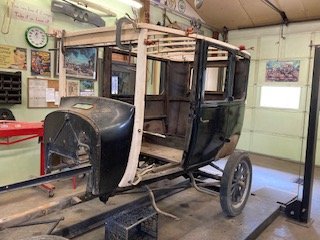

I am not taking the whole car apart. The metal on the pass rear has come loose with the trim piece from the side window Plus the whole top needs do be replaced. I dont see a problem with that. I did restore a 1926 Nash that I had to replace all the wood in the top. Bows rails etc. I have to replace the wood around the rear window but I have all the pieces, plus I have all the top pcs and new A pillars from Fordwood in Utah. They all came with the car. I have restored a 1924 touring that I made and replaced 75% of the wood. I know its a big project but I will enjoy a challenge. I still wonder how they put the nails in the trim piece?
- Attachments
- IMG_0382.jpg (29.28 KiB) Viewed 3110 times

If the trim piece is aluminum, it probably had holes drilled in it the to put the nails through and into the wood. The steel nails have probably corroded to a very tight fit in the trim piece. They would probably have to be carefully drilled out, then the wood repaired as needed, then nail the trim back on and lightly sand the nail heads smooth. If you've done wood and top work, you can probably deal with it. Some provision to keep water and dust from working in around the trim would be a good thing. I don't know how Ford dealt with that, or if they did.

I have the wood temporally installed to make sure it fits.Front window is 1/16 out of square. That can be fixed easy enough. Back doors open and close very nice with good margerines. Now I.ll take it apart and get ready to glue and screw

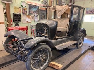

This is what I started with
- Attachments
- IMG_0429.jpg (25.51 KiB) Viewed 3079 times
