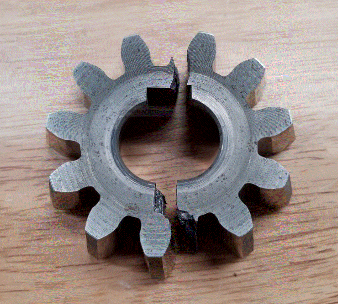

by Ken Lefeber
Mike,
The same thing happened to me 3 weeks ago.
This is what happened to mine.
Hope yours is just a pinion key.

by RajoRacer
Ken - was that a Ford script pinion ?
Re: Differential issue, any ideas?
Posted: Wed Aug 09, 2023 7:05 pm
by Ken Lefeber
No.
Bought new and installed about 2 years and 2200 miles ago.
Posted: Wed Aug 09, 2023 8:38 pm
by RajoRacer
Reason I inquired was that some pinions were made a while back with the keyway in the incorrect position - can't recall which way it was but I have enough Ford pinions to check against yours.

Posted: Thu Aug 10, 2023 9:44 am
by KBurket
Example of keyway in wrong position. Corner of key way should be centered under gear teeth.
Left gear wrong, right gear correct.
Old post with discussion. http://www.mtfca.com/discus/messages/70 ... 1496334174
Another post, which I can’t find now, concluded there were some repro gears that were of incorrect hardness.

by RajoRacer
Thanks for posting that photo !
