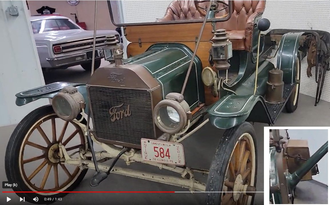

by Rich Eagle
This shows the '21 or later front spring hanger, below wishbone, later spring and spindles. Also, a slope top coil box.
Just my observations.
I also see late running board brackets, battery box and open spool rear axle in other photos.
The body looks like a legitimate early or repro body to me. Also fenders.
I studied this car when painting it and believe it is the same body type. I think 1909.

You can see the generator hanging on the front right of the motor in one of the pictures... regardless of what number is stamped on the boss (in the wrong place for an 11), it's not one. Neither is the chassis. Just saying...
