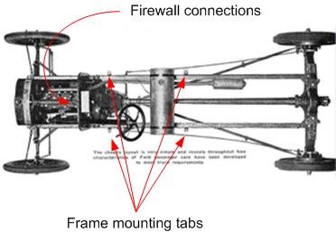

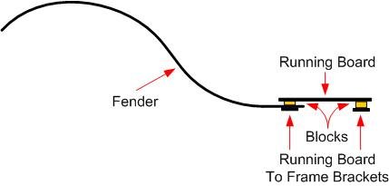

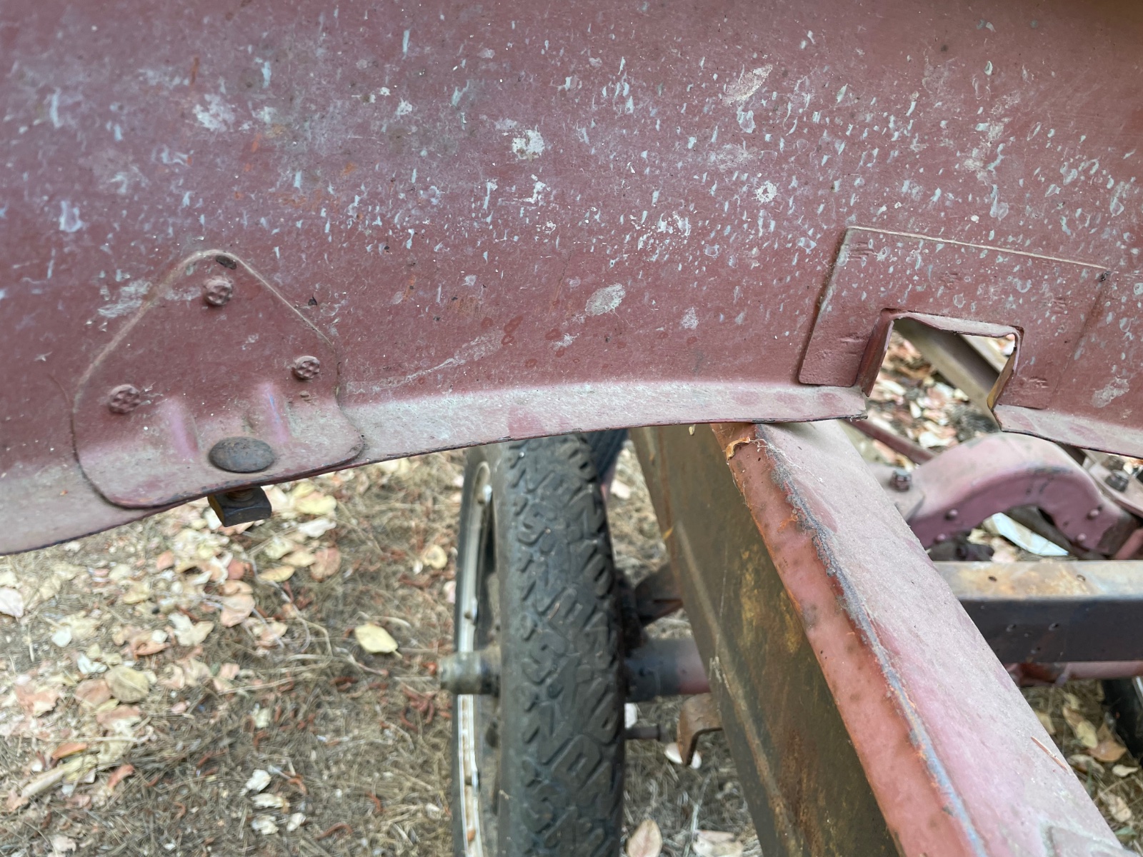

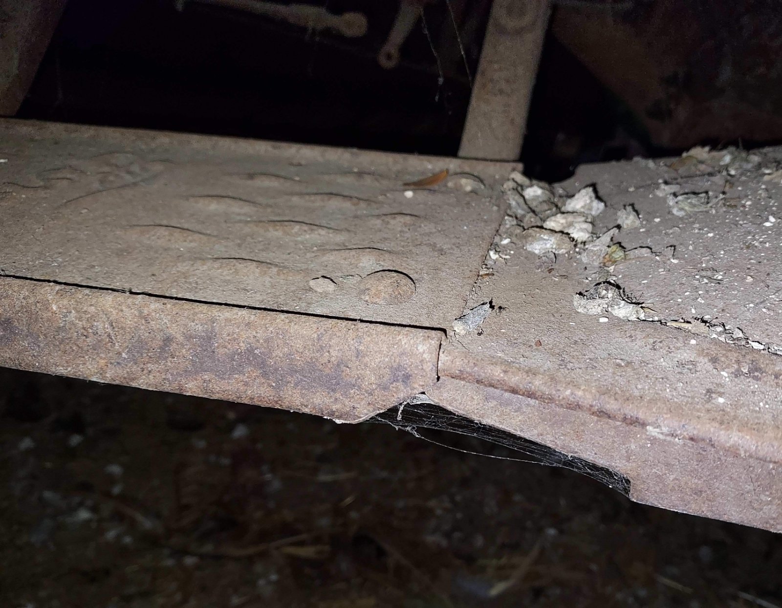

1. Attaching fender to frame/running board. Is the side of the fender where it mounts to the frame mounted on any wood block or steel to steel? I can't see any good photos to confirm how it is attached. As to where the rear of the fender joins to the running board and mount, I see wood blocks involved. Is the following drawing accurate? 2. Attaching cab to frame. There are 4 mounting brackets on the frame, as indicated on the picture below. On a C-Cab, are there any wood blocks or anything else between cab and frame brackets or the cab and firewall? Seems that there is some difference between Closed Cab and C-Cab mounting. 3. Hood rod orientation. Hood panels are in pretty decent shape, except for the sheet metal curls that the rods run through. There are bent in some interesting ways. Just want to confirm that they should look like the drawing below? Seems like that would be proper to allow hood to open correctly as in this diagram. Thanks for any comments, experience, or additional references that you can provide. I have learned a lot on this forum. You guys are great.

1) like you pictured it except no wood blocks, metal to metal.
2) body brackets bolt directly to the frame, no wood blocks.

Thank you Jeff. The pictures say it all. I appreciate it.

When you’re refitting the fenders to the frame make double sure the front fender brackets and the rear fender brackets are straight. This especially goes for the fronts. Over time it’s the front brackets that can get slightly bent or twisted out of shape. Also the channel running board brackets need to be checked for straightness while your at it.
When fitting the fenders, running boards and body use long taper punches to move things into place. Those punches help in the alignment quite a bit.

There are no rear fender brackets on a TT.

When fitting fenders, the first thing I do is bolt the inner edge down to the frame using the two bolts and bolt holes made for that purpose. That should allow you to then bolt the bracket where the triangular inner panel and the fender top meet, to the side of the frame rail. That then becomes the reference point to adjust the front fender bracket to fit, and to see if the running board pressed steel brackets are bent or need alignment with the holes in the rear of the fender.
The key to this is having two fenders with the same profile. I check this by tracing the outline of the outer skirt one onto a large sheet of cardboard, and the lining the second fender up to that line for a comparison. You may have to make adjustments!
