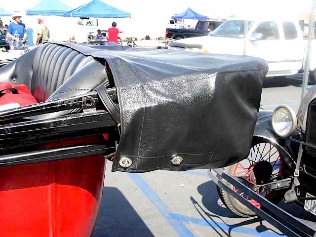

Just get a wide roll of heavy butcher or packing paper and make pattern from folded down top. Did similar making paper patterns for my side curtains that an upholstery shop sewed up.
The top boot would be about 3-5 pieces, the top and bottom, and the sides. Add snaps for closure and then add straps sewn in the upper top, to run over the rear seat and fastened under the seat cushion. The straps keep the top boot from ballooning driving down the road.
