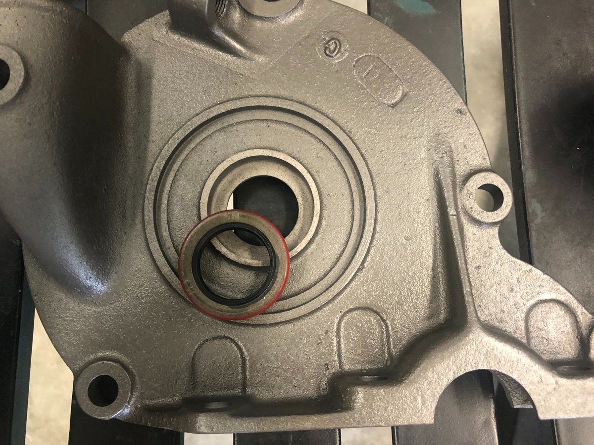

I am planning to use the modern camshaft seal in my timing gear cover. However, it is quite loose in the bore. Not a huge amount, but loose enough and certainly not a press fit. What do y'all use/recommend for securing the seal? I have an idea, but wanted to check with the folks who have done this.

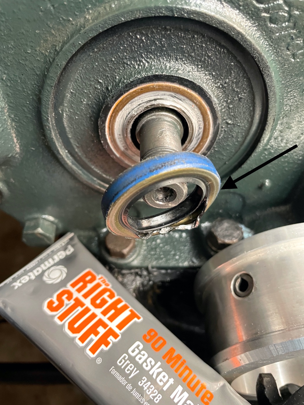

Copious amount of good gasket sealer, the grey Right Stuff. Then wipe off the excess around the seal area.
That will fill gaps and seal from oil leakage.
Had to remove the previous modern seal in the foreground, due to just a tiny wipe of blue RTV, that allowed seepage.

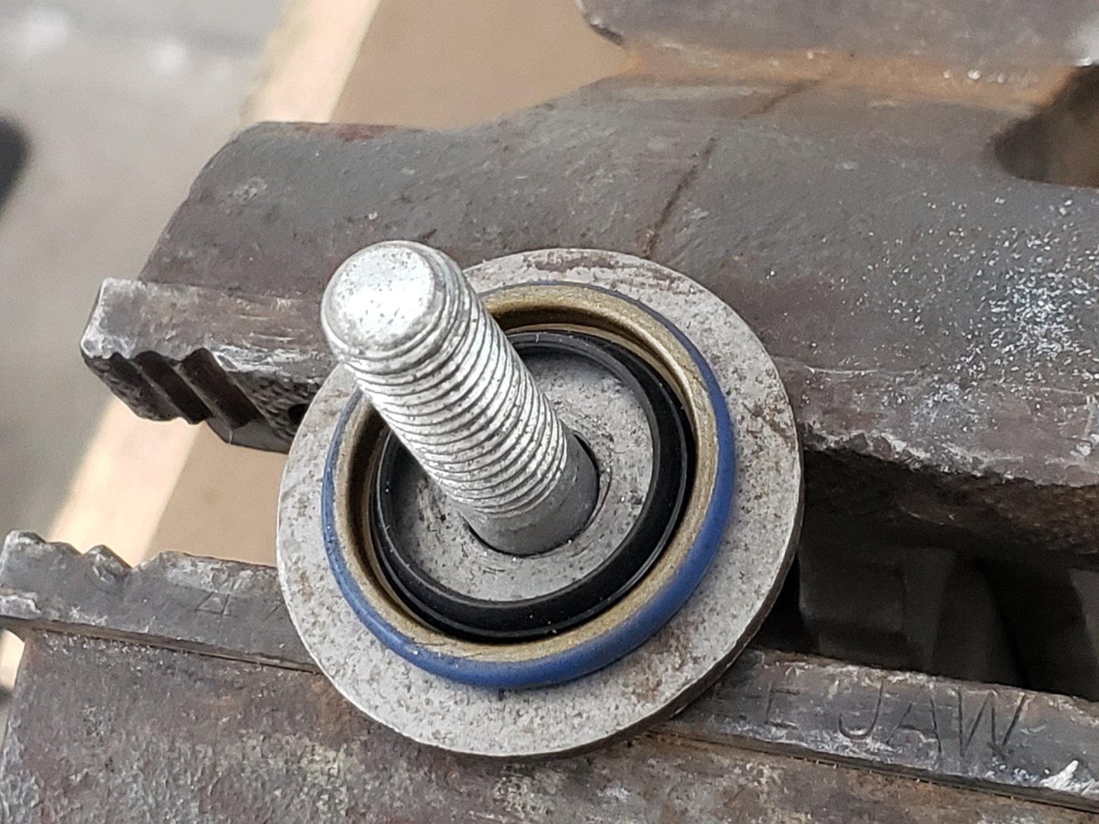

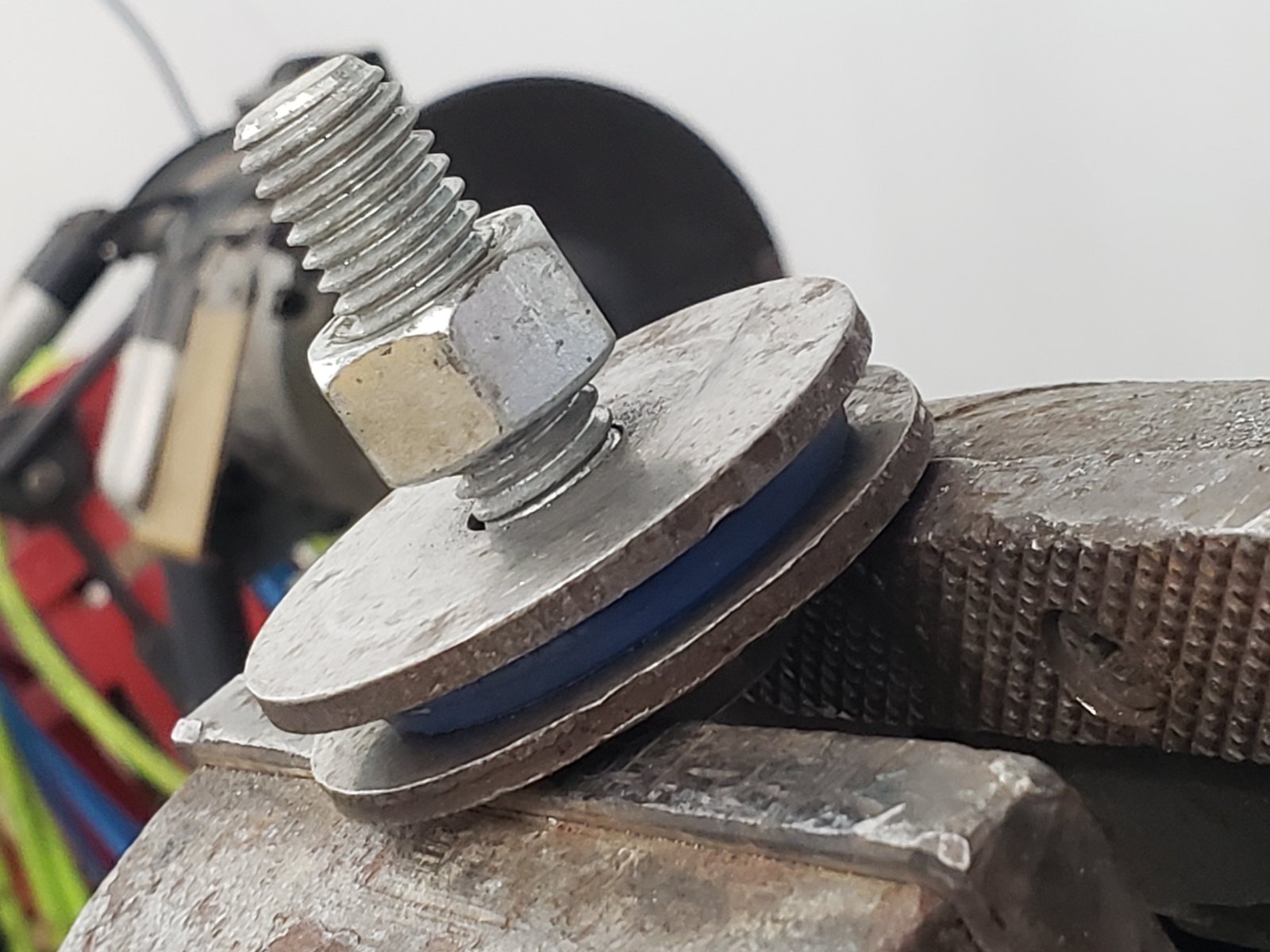

I did something similar to this. I squeezed mine between to large thick washers drawing it together with a bolt and nut. I measured the bore size and squeezed until I was just over the measurement.

I did mine last week. I tried the squeeze thing in a vice with wood, but it seemed very hard and did not want to move. I ended up using Sikaflex 221 to glue it in. It’s a polyurethane adhesive and usually the biggest problem with it is trying to get things apart again.
If I had seen that washers and threaded rod suggestion above, I would have done that and used a bit of Sikaflex.

I like the 2 washers & all thread Robert - good idea !!!
