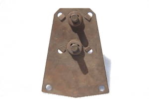

I replaced a starter foot switch in my '23 today. The post that comes from the [+] on the battery tightened down and then started to spin as I tried to tighten further. I stopped tightening. Post tightened enuff. Cable does not move.
Question..... if that cable connection stud has spun and moved while tightening the retaining nut, is the 3 tiered insulating washer setup compromised on that stud???

You won’t know until it shorts out. The stud should not turn. Can you take the switch apart and hold the contact in place while you install a thin jam nut and lock washer to lock the stud in place? You can then check the washers to be sure they are still intact. If they are okay, you can use the regular nut to tighten the cable against the jam nut. Jim Patrick

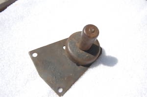

There are two causes for the switch to fail. One is the construction of the switch and the other is in its installation. The installation issue is when the head of the plunger is to high above the floor, note that it shouldn't be more tan the travel distance to make the internals contact. When its to high additional pressure on the plunger will cause the shroud around then plunder to bend around its base, this then puts it on an angle and only one contact is engaged. As a result the driver, out of frustration, applies even more pressure and at sooner or later a short follows
This plunger appears to be too high, given the travel distance needed for the switch contacts to meet.

When tightening or loosening the cable connection on the starter switch, if the stud turns it is not necessarily a problem. I recommend using a thin wrench to hold the lower nut when turning the outer nut, same on the starter motor...even more important for the starter motor because spinning that stud will damage it.
One problem using a modern tractor starter button is a tractor starter button is depressed with the hand and not the foot. Using a replacement tractor starter button sold by farm stores and some model T parts vendors and stepping on it by the heel of a foot may put a side load on the plunger that it will not handle. Also, like some model T repo parts, many tractor parts available today are made in China and are not comparable to the quality of the original USA made parts. This is one of those parts that is better to find an original and restore it.

The foot switch nuts and bolts contacts have to be treated the same way as the starter stud bolt where the cable attaches to. They aren’t really backed up internally enough to really tighten them down. Use a thin wrench to use on the outer nut and tighten down the cable with another wrench.

I only have one nut on each stud instead of the proper and correct two per. So the cable end is compressed against the switch base, not against the 2nd nut.

The trick is, since the top side of the bolt used in the starter switch can't be accessed, you can take a thin cut-off wheel in a die grinder and grind a slot in the stud that keeps spinning. Take a blade screwdriver and insert it in the slot and hold the stud while you tighten the nut. Get it good and tight so it won't twist again. Now, place the battery lead on the stud, a star washer on top of that, and the second nut.
