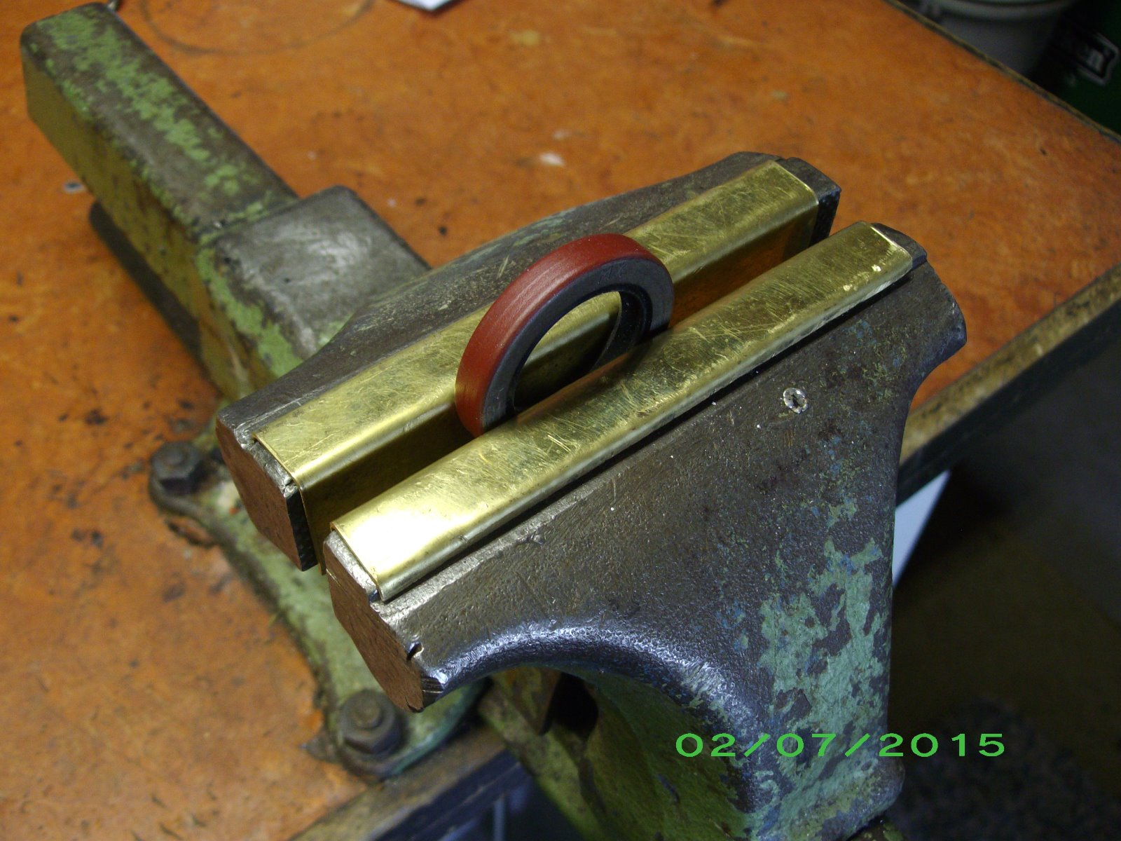

Don A . I have good results as I do it as on the picture

Two pieces of wood and a vice works; you just have to do it a little bit. Measure before and after. You're only looking for 0.005"-0.010" diametric growth typically. Seals are cheap, so my suggestion is to try it again, but any of the above will work, too. If you're using an oiled timer, it doesn't have to be perfect - the felt wasn't. If you're using a brush timer, it needs to be pretty much perfect.
