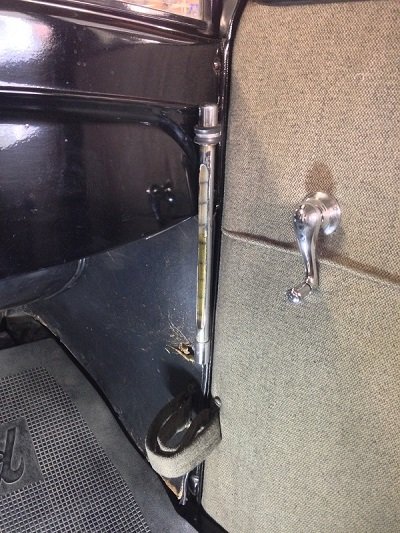

by jsaylor
Similar to this one in my 27 Tudor.
gas guage.JPG (87.36 KiB) Viewed 5559 times
Re: Where does this go???
Posted: Wed May 22, 2019 3:21 pm
by George House
OK, I’m a visual kinda guy and now I see where that accessory gas gauge is planted. But how is it integrated into that ‘upside down question mark’ New and Improved gas line ? I wrongly assumed it fastened to the sediment bulb.
