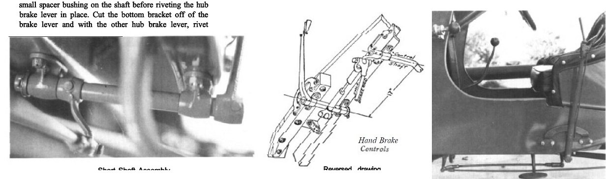

Some of the speedster guys do it. Here are some old threads:
http://www.mtfca.com/discus/messages/59 ... 1472061244
http://www.mtfca.com/discus/messages/506218/522583.html

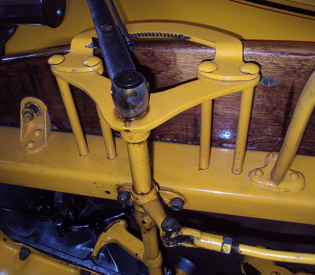

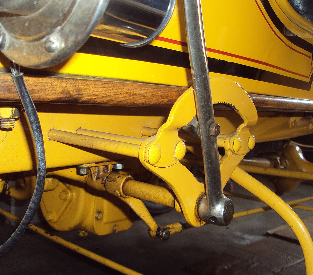

Here is how I did it on my speedster. You can lengthen the cross shaft or make a new one. The using tubing standoffs and carriage bolts mount the ratchet out farther. The lower bracket was fabricated.
