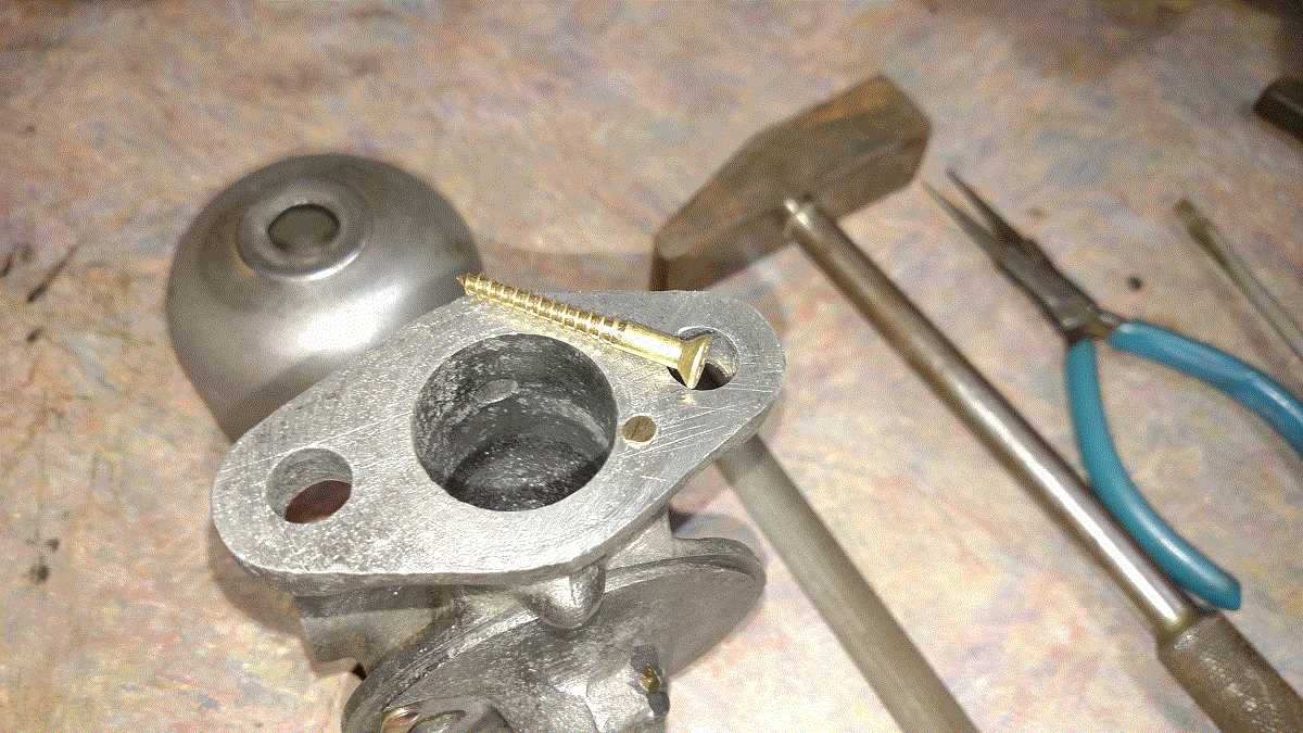

by Mark Nunn
AndyClary wrote:
Wed Nov 01, 2023 9:18 am
You can plug the passages back up with soft brass like brazing rod.
Andy
I did not have brazing rod but my hardware store had brass screws. I cut pieces from the screw shank.
