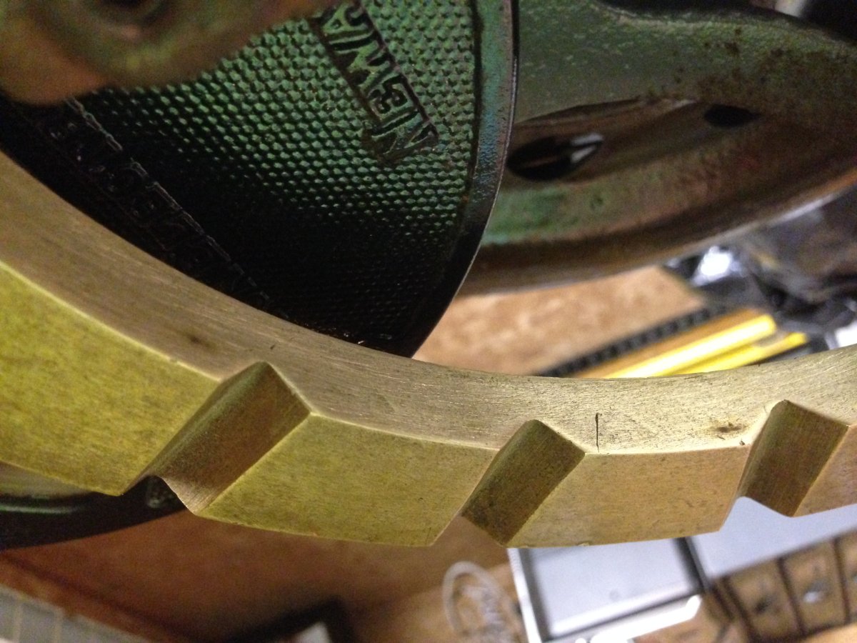

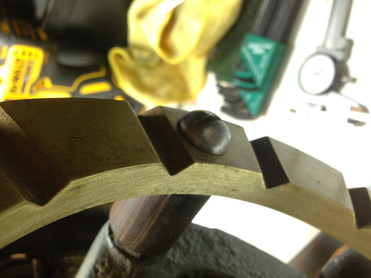

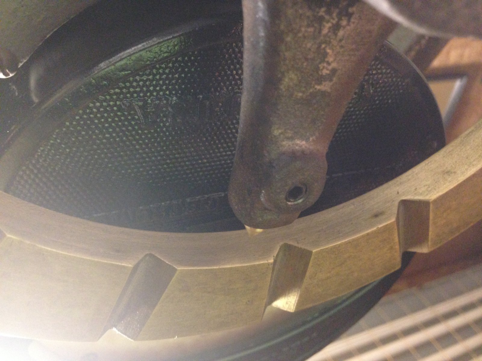

First off, I'm a newbie to using an HCCT and fully understand that I understand very little. I have a professional rebuild my coils, but I happened into the opportunity to buy this HCCT and like to fiddle with it. (Read as please refrain from suggestions to have a professional do my coils or to try xyz type of tester). My HCCT is a Service Station Equipment Company unit. I was supposedly rebuilt quite some time ago. I was putting 8-10 coils across it this evening, basically experimenting without actually doing any coil adjustments. Before I started, I thoroughly cleaned the ID of the brass ring and the pointer and set the point gap to a smidgen under 1/4". In testing the coils, it seemed like, generally speaking, every other spark on the ring tended to be stronger. In other words, every other spark location on the ring tended to look weaker when it did jump, didn't jump as often, and for some coils didn't seem to want to jump at all. For some coils, all 16 locations seemed to work fine, but for coils that weren't perfect, the "good" and "bad locations were always the same. After finishing, I noticed that my observations seemed to be confirmed, as every other location had a small brown spot where the spark jumped. The locations with the brown spot are the "strong, easy spark" locations. To be clear, it's not the brown spot that I see as the problem or that some coils didn't behave right, it's the "every other location" aspect that seems wrong/odd to me. What's going on? Field coil or magnets? Why is it such a clear pattern?
I took photos of the spots to show how they are on every other location. Sorry about craning your neck - the iphone thinks it knows which side is up.

Thanks, Mike. On the second point, I should have stated "for a given spark lever setting", as yes, all four would switch if the lever was adjusted to the next 22.5 degree timing position.
On the last point, I agree that the actual spark plug theory is driven by the center electrode being hotter and thus it is desirable to have the center electrode be negative. On the HCCT, temperature is not a driver, but I think shape of the electrode does matter. The pointer comes to a sharp point, and the ring doesn't. I think it has something to do with the field or elections being concentrated in that point that makes jumping from pointer to ring easier than from ring to pointer.

What did you use to clean the brass ring and pointer ???
I use a crocus cloth or fine steel wool to clean and brighten both metal parts before using my tester. Oxidation and corrosion, however slight, will insulate spark points on the HCCT. I learned that from a great friend.

Green scotchbrite and some fine sandpaper - 400 or 600 grit I think. Then I checked continuity everywhere.

Does the pointer run concentric within the spark ring ??? Spark ring , to me, does not shine like it should, can't see the pointer. Unequal pointer/ring distance will cause visual differences in spark. When testing coil, is the meter needle steady at 60 rpm's ??

Yes, I painstakingly centered the ring, and the ring is round. I think it's working okay based on a good coil doing what it's supposed to. The "every other location" was what seemed odd, but I think we got it figured out based on the A/C sparks. I think things make sense now. Those are good ideas, though. Thanks; I'll check them again next time.
