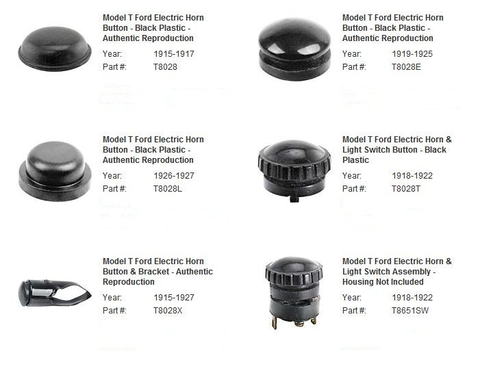

The horn button is definitely the one on top in the vertical row to the right, T-8028E for an electric horn. I'll check the backside of the center piece (what the heck is it called?) tomorrow and report back.
Marshall
