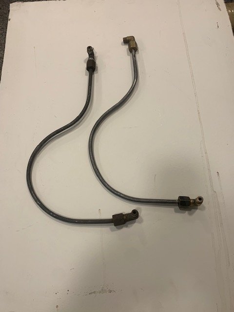

John,
These are two originals. They are made of rolled flat material that is then soldered.
