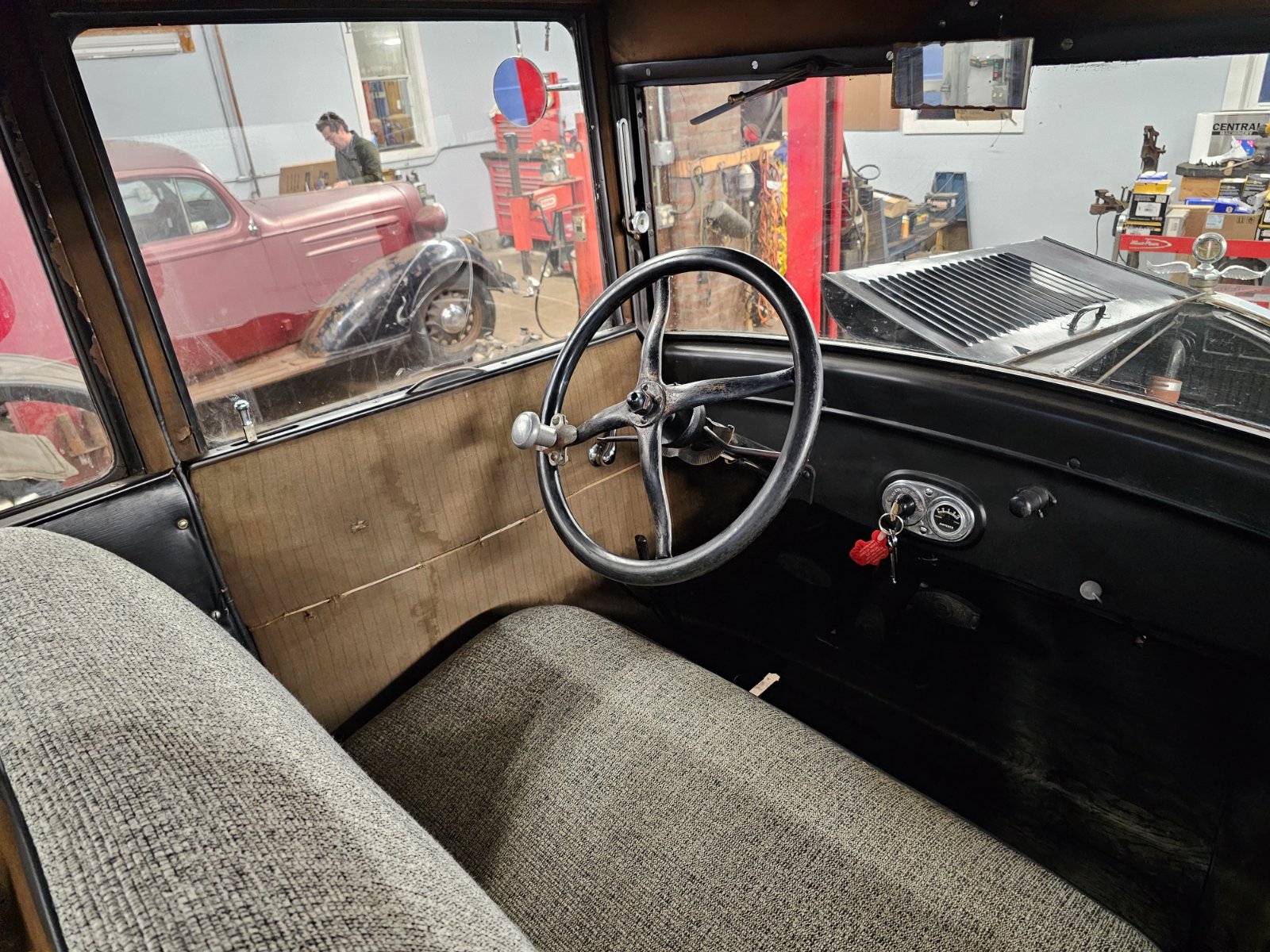

New T owner here, just wanted to introduce myself and show a few pics of my car. I'm 26 years old, bought a '26 Coupe earlier this year that's been in storage since 1987, and I've been working on getting it back on the road and learning to drive it. So far I've done all the preventative maintenance, new tires, recovered the seat, etc and it's running well. Just fitted an aermore whistle to it, and planning on swapping in a Ruckstell axle over the winter and a higher compression head if I can find one. Just fighting a persistent issue of it draining the battery after a couple days, and trying to seal up some oil leaks right now. Hopefully it's going to be my daily driver come spring, and I have big road trip plans!

A slow battery drain in a T is unusual. Assuming it has a stock electrical system with no added electrical accessories, about the only thing likely to drain the battery with the car sitting is the cutout relay on the generator, and if that sticks shut, it will very rapidly drain the battery.
The battery itself may be the problem, or dirt on top of the battery.

Thanks, I'll check that out. The electrical system is all stock, might all even be original. The cutout relay is just that little gold can on top of the generator, correct?
