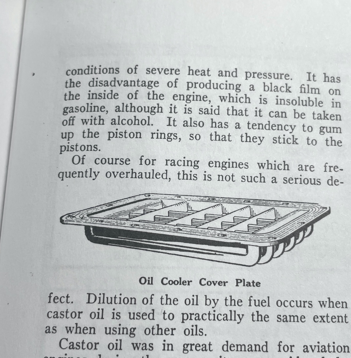

and does anyone know if the generator cover is 'period' correct or not?
That generator block off plate or cover would be more modern, still avail from Lang's # TG1.
Haven't seen similar in old time catalogs for T speed parts.
However, might still be ok, as there was a period alum. and finned oil pan cover, so it could fit the look. :?
