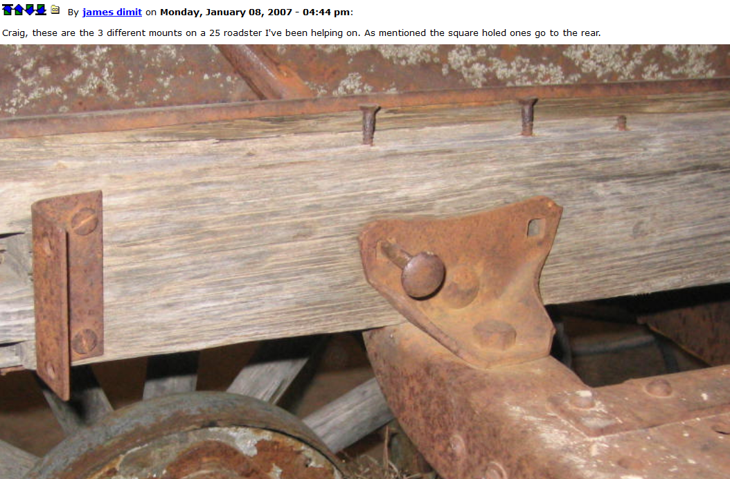

By james dimit on Monday, January 08, 2007 - 04:44 pm:
Craig, these are the 3 different mounts on a 25 roadster I've been helping on. As mentioned the square holed ones go to the rear.
