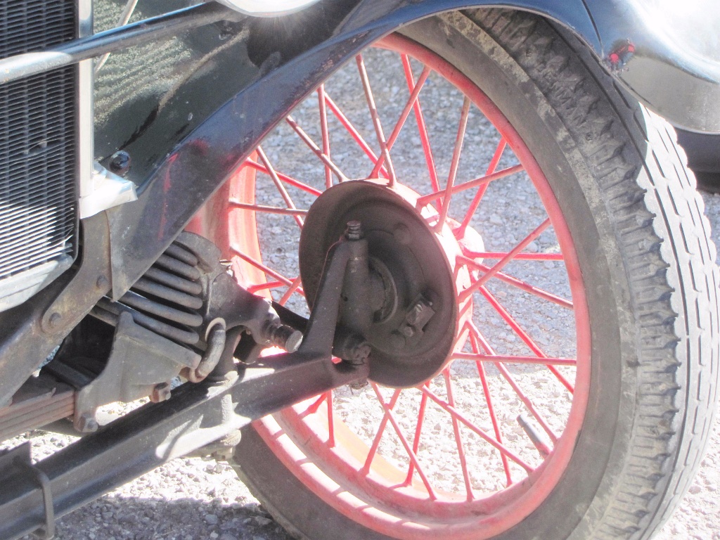

Those Hasslers can make the T ride a tad better, as they do react to the lumps in the roadway.
But, having bumpers isn't a real necessity, so just drive with care, helps to learn to stop safe. As for damage, the front tires if head on can be rubber bumpers, and at angle, the fenders tips will prevent radiator damage. :)
Just not enough room for the accessory Ford brackets on the front, they hang down from the frame rail. Would interfere with the Hasslers, either beehive or pancake.
