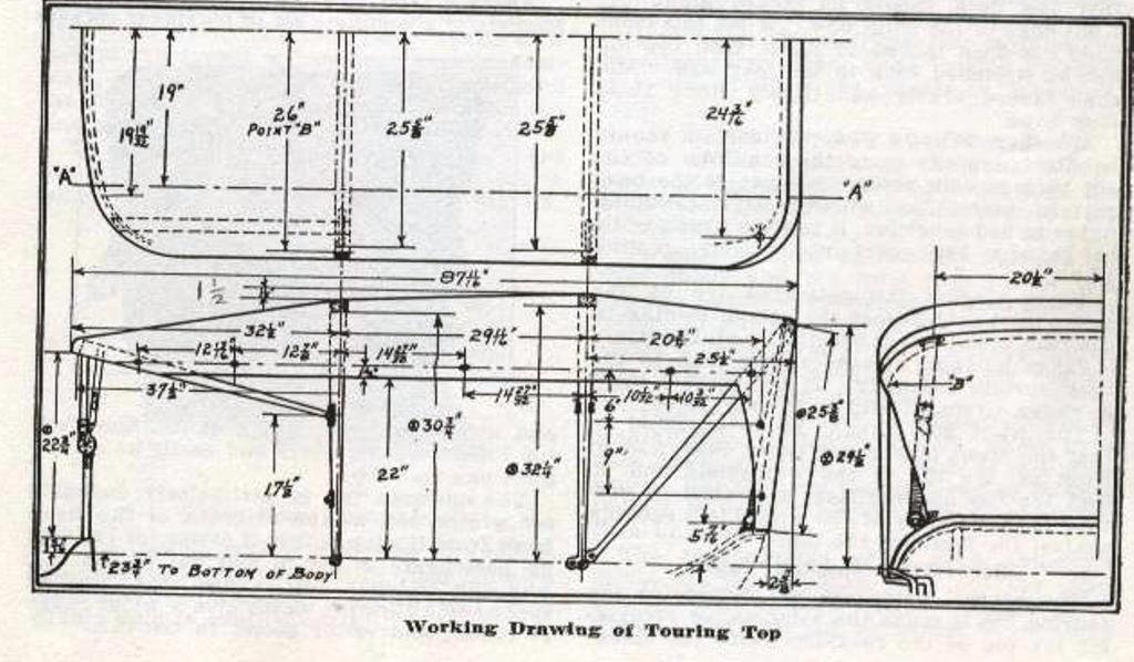

I have new wood top bows and I need to know how long each one needs to be. I know this has been answered before, but I just cant find where it is. If someone could give me the measurements or direct me to where the question has been answered before I would appreciate it.

Here is his.
It isn't as easy to find old discussions on the Forum recently. At least for me. I know there are some good ones on your question.

Thats it!!
Thank you!!

Thanks the same diagram I used for the top bows on my '17 Touring. So far, so good.
