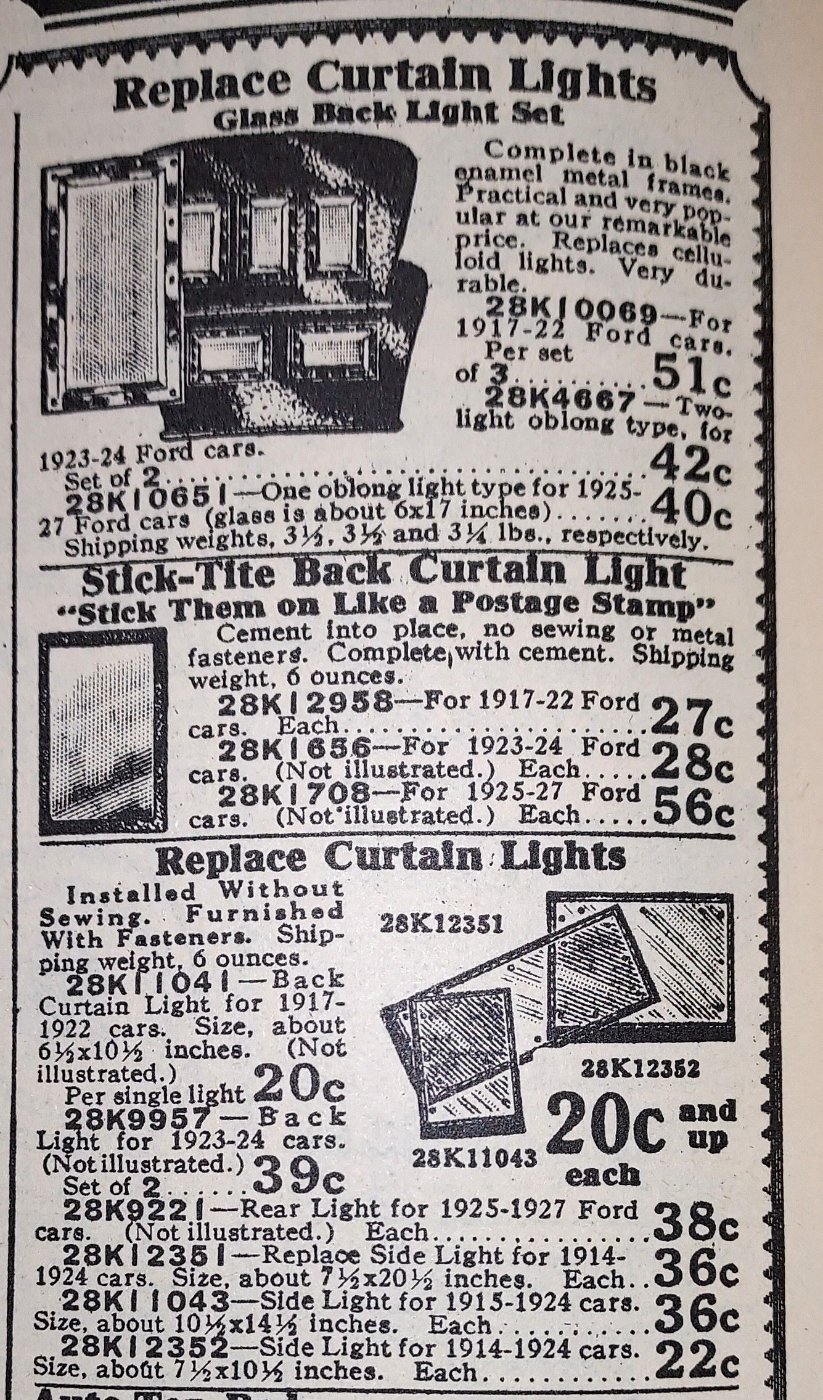

I went out and measured the hole. The actual opening is 7 1/2 x 16 1/2. The stitching was in two rows. If you went to the outer stitch it would be 10 x 19 but I don't think that would necessarily have to be done. Anything larger than the hole itself would be great. I can always cut the hole to fit. Thanks again.
Re: Advice needed for touring rear window.
Posted: Sat Jan 13, 2024 8:08 am
by Humblej
This is from the Sears Roebuck catalog from 1927. Whatever type of repair you decide to do it will probably be a 2 man job.
