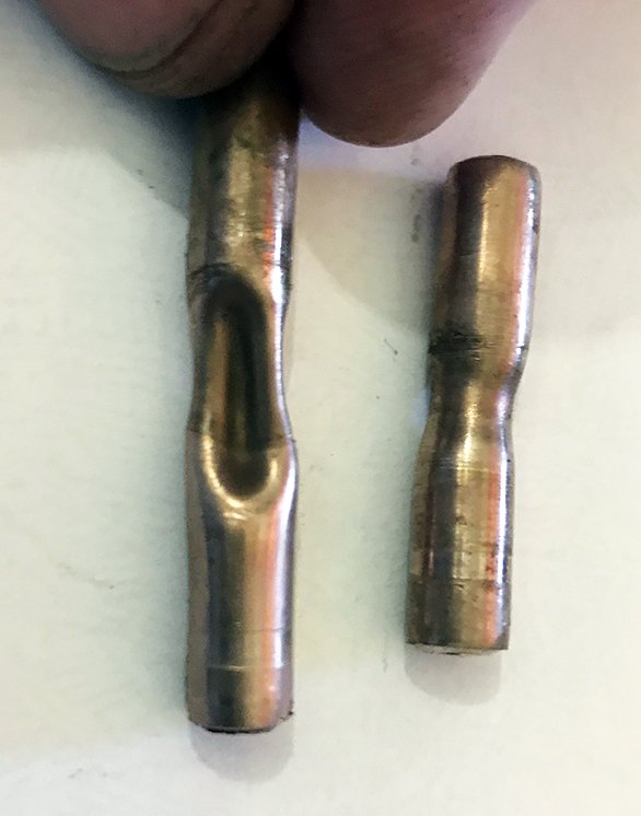

Brass would be the way to go although some plastic ferrules are made of material that resists the components of modern fuels. worst case, you can order brass ferrules online. If your hardware is part of a national chain you can order online and have shipped to the store.
To hijack the conversation slightly, I use steel brake line for fuel lines after a bad experience with Nickel-Copper lines. This is what happened to the ends that were sealed with neoprene packing and original brass nuts. I discovered the problem when I noticed a very slight fuel leak. The deformation occurred at both the valve and the sediment bulb. Pure copper may be better. I've had a copper fuel line connecting an auxiliary tank to a main tank in my 1946 Airplane that has held up for 40 years. It has been exposed to vibration the like of which we never experience in a Model T.
Dont mean to be harsh. As I stated, I have seen the catastrophic failure using a copper line with compression fittings twice to the same guy.
The line shears @ the compression ring edge. This must be the worst connection method.
Is your airplane fuel line also connected with compression ring fittings on copper? A tall flair nut fitting is a better way to go - no shear line.
The condition of a collapsed line blocking fuel flow doesnt bother me so much. Poor performance from the restriction is an easier lesson to learn than having a T or bunch of T's burn to the ground.

I've seen a lot of copper line break at the ferrule or get necked down at the ferrule, constricting flow. The nuts sometimes split or flare out, too. I'd avoid using that type connection on anything automotive. They give enough trouble on things like ice makers and swamp coolers.
