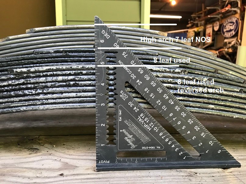

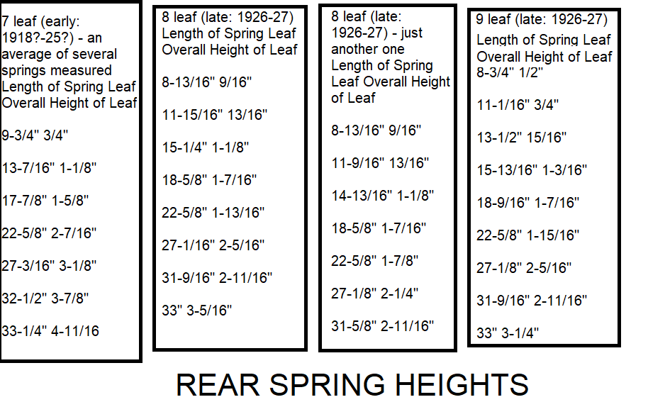

You defined your chassis etc: I am starting with a 27 Depot Hack chassis and that is what I am converting to a 1917 T ambulance. But, it will always be a T salad. Just trying to represent the species with this project. So, yes, 27 fenders and running boards, radiator and hood and yes, 21" wheels to go over the 11" rear brakes. And, yes, it wil have a starter.
There is always a question if your starting with an unmodified 27 Depot Hack chassis
-Spring height will affect height as well (do they each have 9 leaves)
I don't have an 9 leaves for comparison but old vs new makes a difference. Picture is to give you an idea of differences. Also you overall body weight will affect height.
Unofficial Measurements
FRONT Springs
REAR Springs
1926-27 Front spindles - lower height about 1/2 inch
