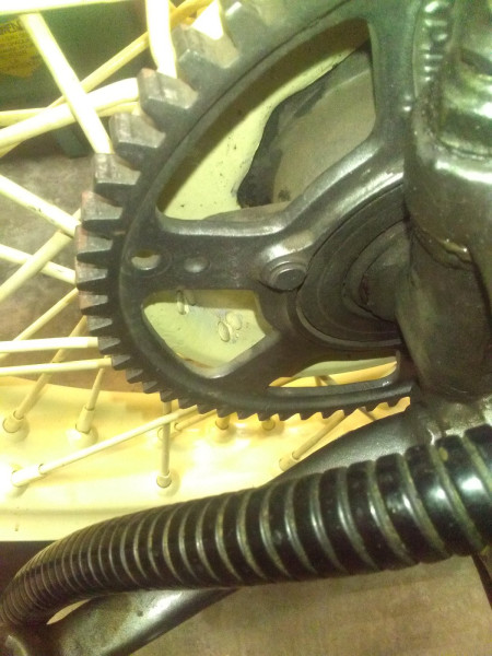

Buffalo hubs (not all) have three tabs that protrude out from the inner edge of the hub to mount the road wheel using three machine screws. Seems Dayton hubs may not have this feature, but you could make up three tabs and tig braze the tabs on your hub- In the picture below you can see one of the mounting tabs behind the road gear. Another method- Stewart made a road gear with about a 3" diameter center to mount on year? a Ford hub that had a machined feature on the inner edge to mount a road gear- locate one of these and machine the inner edge of the Dayton hub to clean up and then make a spacer to mount the road gear that way. Sorry, this picture is not the best, but you can see the mounting tab, and this road gear is the one with the small center hole to locate it on the hub.

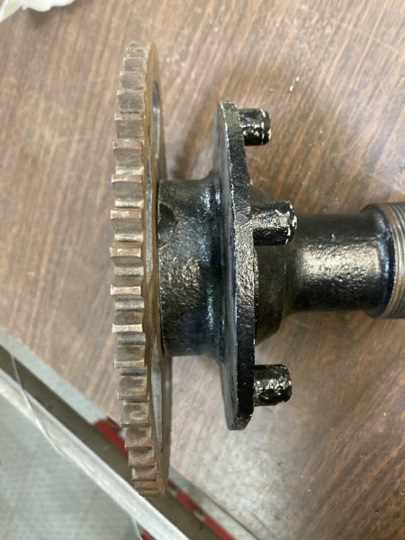

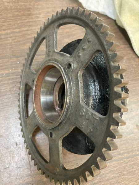

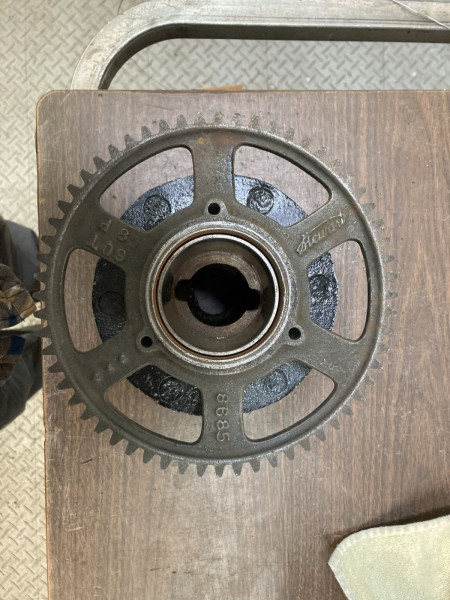

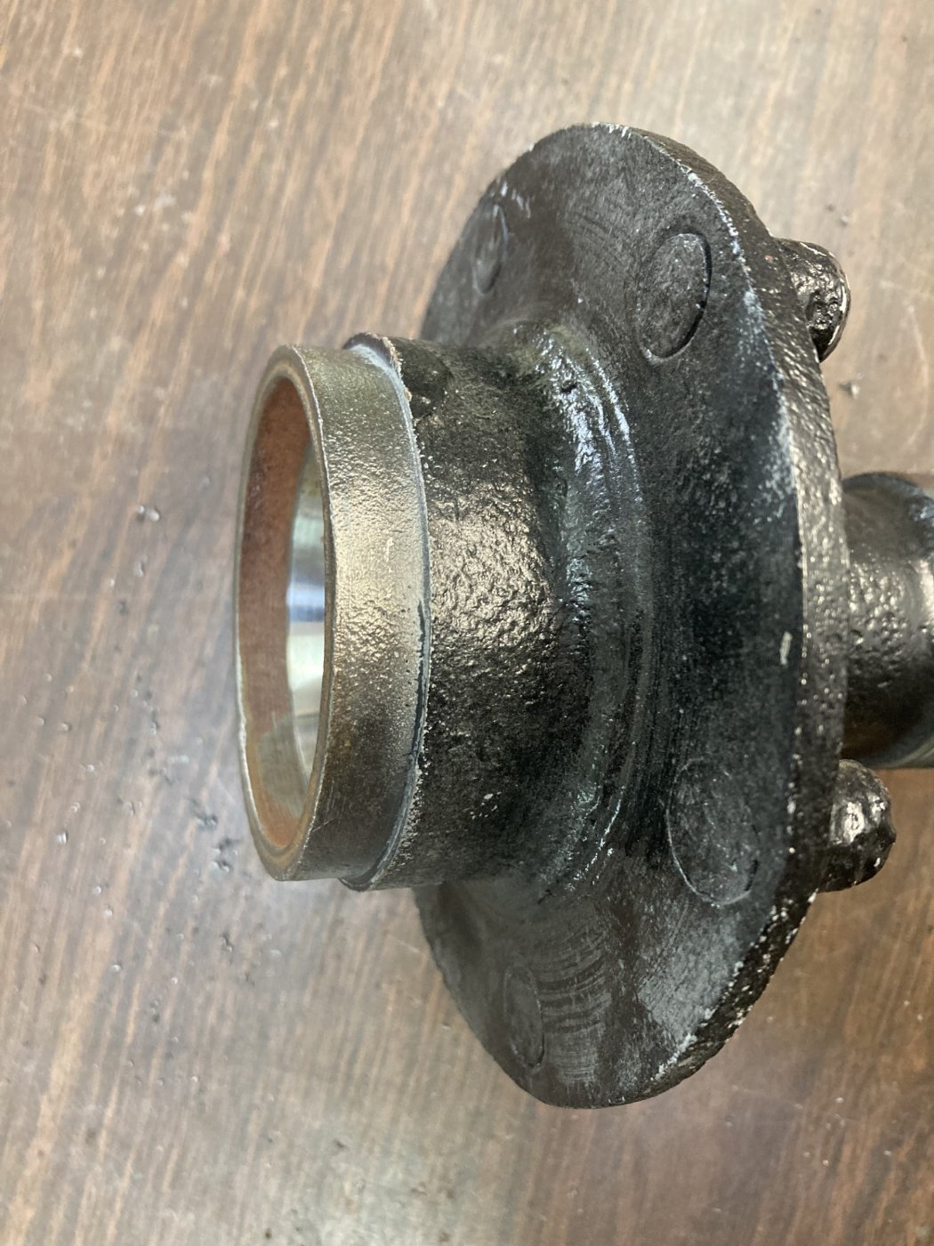

I have a set of Dayton wire wheels, and the Stewart road gear that fits the wire wheel hub is #8685. There are no "tabs" to screw the gear to, BUT the hub is machined to accept the 8685 gear so the runout is perfect. The gear and hub are nearly a press-on fit. I hope this helps. Russ Furstnow

Russ is showing the same road gear as in my picture. It would still be possible to drill and tap the hub flange and use long screws to hold the road gear afainst the hub if your Dayton hub has the machined shoulder, if not then simply machine the hub smooth and make a spacer ring if necessary to center the gear.

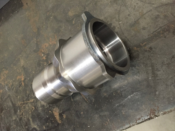

Those tabs really complicate the manufacturing of new hubs, so I leave them off. To add that capability I make a ring that shrinks on to the hub. Brazing or welding will likely cause distortion of the bearing bore, but I have found that a .002” shrink fit is enough to retain the speedometer gear without distorting the bearing bore

Thanks Kevin, that looks like a good way to go. Maybe add some green loctite stud and bearing mount as well.
