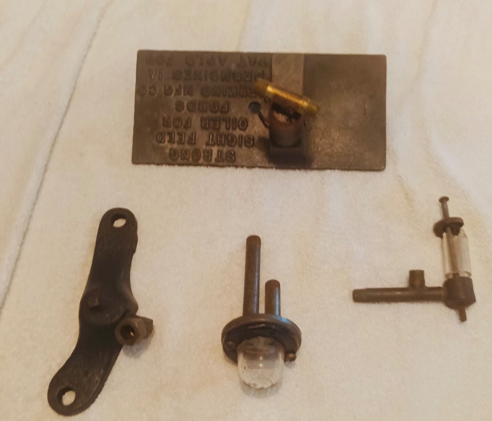

Posted: Mon Feb 19, 2024 12:29 pm
by Jay In Northern Ca.
strong 1.jpg (63.12 KiB) Viewed 1967 times
strong 2.jpg (72.97 KiB) Viewed 1967 times

Posted: Mon Feb 19, 2024 12:40 pm
The Strong device was only made for the dual valve cover engines and was never continued into the single valve cover engines.

Posted: Mon Feb 19, 2024 12:59 pm
by Bryant
Thanks Jay! I don’t have one Norman. I just think there neat and didn’t know if they offered it for the later blocks. The picture is from a recent classified ad that had sold.

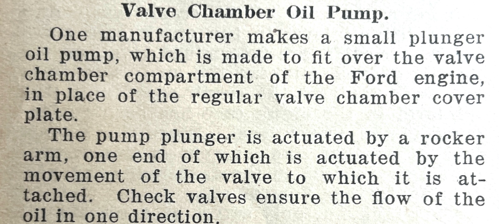

Posted: Mon Feb 19, 2024 2:16 pm
by DanTreace
If that plate has a lever on the inside, that could be accessory pump to push the oil. Since it's complex, likely few sold, and wouldn't be also made later for the one-piece cover.
Info from Sept. 1920 Ford Owner and Dealer magazine.
