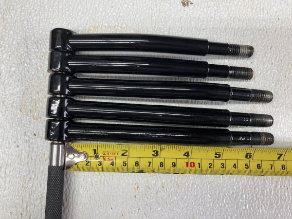

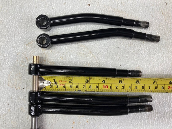

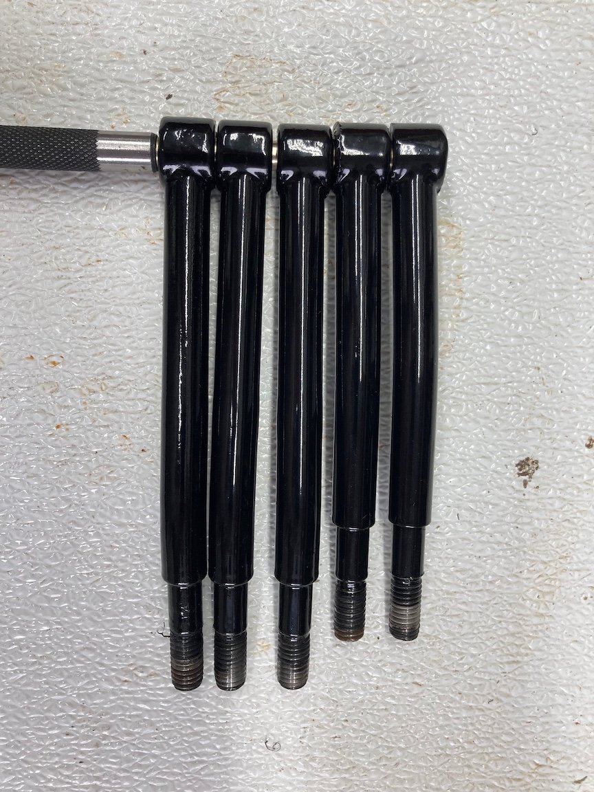

Just picked up the front legs for the front seats in the Tudor and noticed something interesting/confusing.
The legs are actually 2 different lengths. Not sure if this is to adjust between a tall driver and a short passenger and vice versa or maybe legs from 2 different years?
Any idea which seat gets which length leg?
Thanks for any thoughts,
Joe

You only need four. Two for the front of each seat. Pick the ones that suit you for height on the driver's seat and use the others for the passenger seat. They have a little bend in them so you can adjust the seat forward or back by rotating them 180 degrees. Sorry, I don't have my 27 Tudor any more or I would go out and measure them.

Thank you, John.
They do just screw in so I can switch them over if I want to adjust the height of the seat - so that's my new plan.
