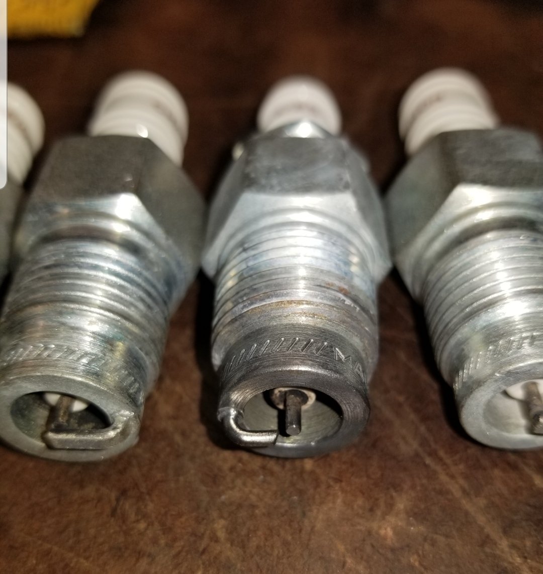

Posted: Mon Mar 18, 2024 6:52 pm
by vping
Would love one of those. Nice to hang on the wall and if it did different sized plugs, very handy too.
Currently in the car are Champion 25. I have another set of those as a spare but one of the 4 is a 2 piece style and has a different tip.
I also have a set of Champion X. Also 2 piece style. One has broken porcelain. I'd like to find a new porcelain and then clean up and try to use. Anyone have a spare porcelain?
Feel free to educate me on what these 2 piece plugs are called.

Are the nuts on the top of the plug backing out with vibration? Just something quick to check.
Re: Spark plugs
Posted: Mon Mar 18, 2024 7:41 pm
by vping
Haven't had it running long enough to determine that yet. It's something for me to think about once I do get it on the road.
Re: Spark plugs
Posted: Mon Mar 18, 2024 8:30 pm
by CudaMan
If they are take-apart plugs, also check to make sure that the thin nut that clamps the porcelain to the shell doesn't loosen with vibration (yes, it has happened to me before). Keep it tight, but not so tight that you crack the porcelain. If you do crack the porcelain, you'll get a misfire that manifests itself only under heavy engine load (yes, I've had that happen too). :)

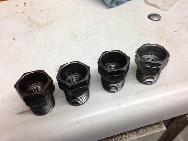

I kind of like new Bosch model 14 mm plugs with adapters. Seem to last for years and hardly ever foul. Bosch 4003 are my favorite! They get down closer to the top of the piston.
Re: Spark plugs
Posted: Tue Mar 19, 2024 8:04 pm
by vping
Are the adapters to reduce the size?
Re: Spark plugs
Posted: Wed Mar 20, 2024 11:01 am
by Craig Leach
14mm plug adaptors cam be made from old spark plugs ( the crimped ones not the ones you can take apart ) They look correct. They can also
be used to repair over sized or damaged plug threads.
Craig.
They are to allow you to use the smaller diameter 14mm plugs in a head that's threaded for 1/2" pipe thread.
