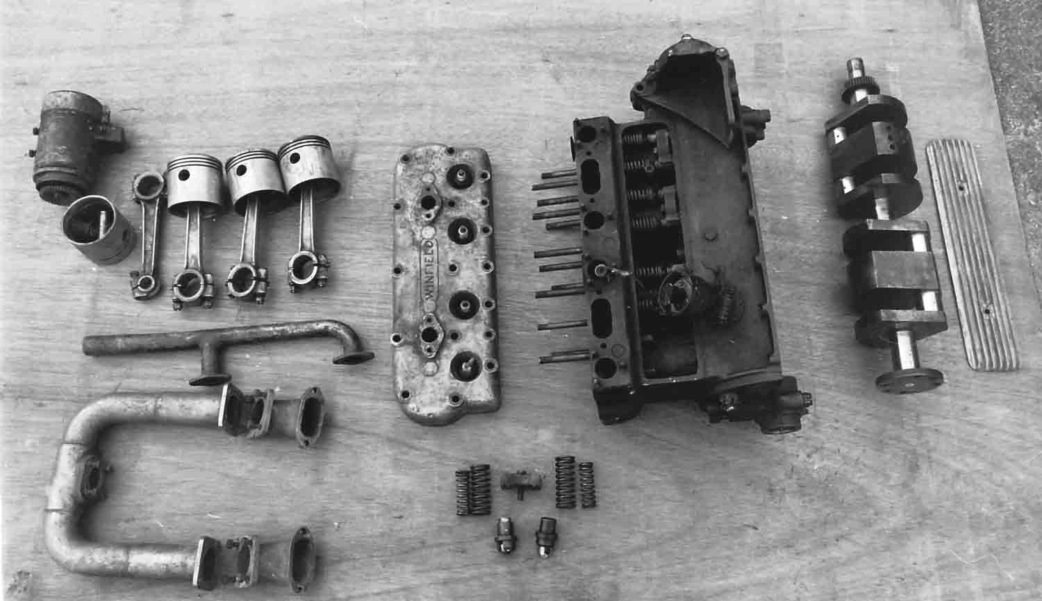

Steve, It's made to fit a Model T, I have one too, mine is pretty old. I believe it was originally intended as an updraft. Horizontal ports were used in T blocks back in the day. Photo of is the Ed Winfield engine, not mine !
