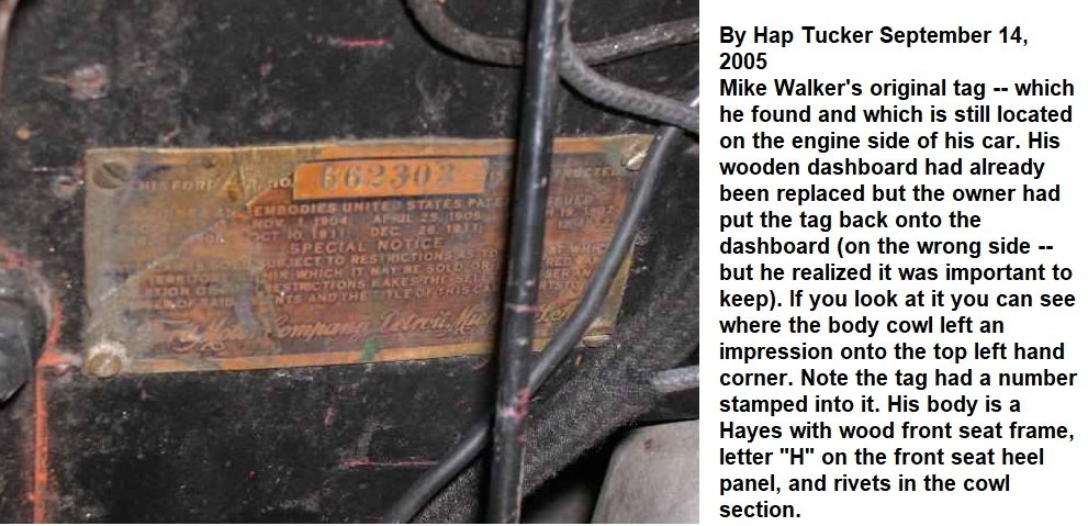

From reading this discussion. https://www.mtfca.com/discus/messages/29/6661.html
It also explains
by Hap Tucker , September 16, 2005
"The engine numbers and the number stamped onto the ID/Patent plate usually matched from at least the 1906 Model N and later R & S cars. But then sometime around 1911 or so I think -- I need to look that one up, they started to diverge. I have never found any reason listed for why they began to diverge but sometime along in there or shortly after that they did. By 1915 they had gotten quite a bit different even to the point that on Apr 29, 1915 they issued a factory letter stating, "On or after May 1, the use of body numbers will be discontinued (by Ford) and no records will be kept of same." See Bruce's on line encyclopedia at: http://www.mtfca.com/encyclo/doc15.htm That is why I thought your car would be an early 1915 -- as your plate still had a number stamped onto it. They continued to use the same plate -- but they just left the area blank -- which is shown with Jim Cook's early 1916 ID plate above. "
