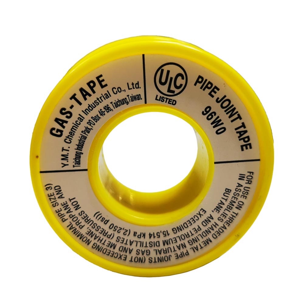

Do not use Teflon tape or sealant for "gas" valves (that's natural gas)
If it for gasoline make sure its soft setting and will not harden. There are lots of discussion on how to get the sediment bulb off when stuck.
Haven't used it but others have

Are you installing an original cast iron Ford script sediment bulb/valve? Yellow Teflon tape is what you use for gasoline fittings as long as the threads are sharp and not damaged or pitted, otherwise, use the pipe dope. Just be sure it will stand up to gasoline. For a sure seal, feel free to use both. Jim Patrick

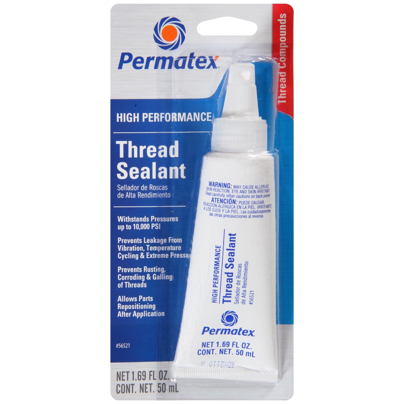

This stuff if pretty good, I have used it more then a few times and seems to prevent leaks on gas fittings, along with being rated for that application;
https://www.summitracing.com/parts/ptx-56521?rrec=true

Mark. I read all the information the Permatex link and cannot see where it is specifically for gasoline. Are you sure it will stand up to gasoline? Knowing me, I probably missed something LOL. Respectfully submitted, Jim Patrick

Read the specifications. It does mention fuel fittings.
The yellow. "gas" rape is for natural gas not gasoline

by Mark Gregush
For John;
* Contains PTFE
* OEM-specified
* Standard applications: stainless steel fittings, head bolts into through holes, oil psi sending units/sensors, oil and coolant lines, intake manifold switches, rear axle fill plug, fuel fittings
* Motorcycle applications: timing hole plug and oil hose fittings
* Heavy-duty applications include drain plugs, all tapered fittings

I agree that PTFE tape can be used for gasoline. BUT I don't trust the color of the tape to indicate its overall use (too much stuff made overseas :cry: ) prefer that it states what its made of Material Polytetrafluoroethylene or just PTFE
Oatey is available most everywhere & looks like I'm headed for Harbor Freight Today

I was replying to Johns post about the Permatex sealer not the tape post.
